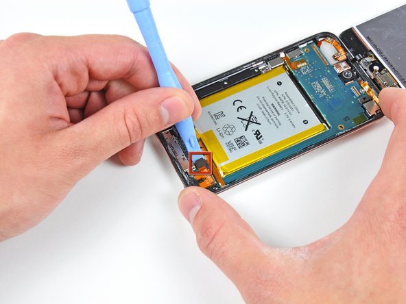

    • Use an iPod opening tool to pry the headphone jack connector up and out of its socket on the logic board.

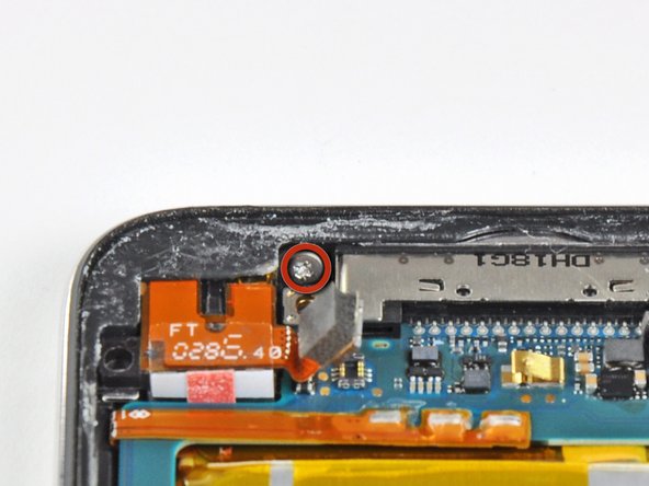

  10. iPod Touch 4th Generation Headphone Jack Replacement: step 10, image 1 of 1
    • Remove the single 2.6 mm Phillips screw securing the headphone jack assembly to the rear case.
    • The screw is at a 90 degree angle. Make sure to remove it at such an angle.

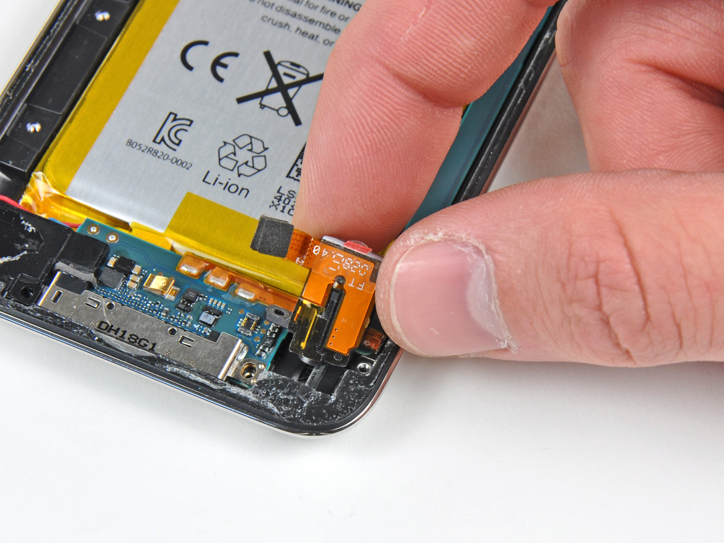

  11. iPod Touch 4th Generation Headphone Jack Replacement: step 11, image 1 of 2 iPod Touch 4th Generation Headphone Jack Replacement: step 11, image 2 of 2
    • Use an iPod opening tool to gently lift the edge of the headphone jack nearest the battery out of its recess.
    • Remove the headphone jack from its housing within the rear case.
