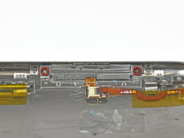

Add Note Edit Step 33 — Power/Volume Controls  ¶
  • Remove the two Phillips screws securing the power/volume controls to the rear panel.

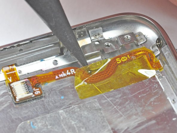

Add Note Edit Step 34  ¶
  • Use the tip of a spudger to remove the yellow kapton tape covering the power/volume control ribbon cable.

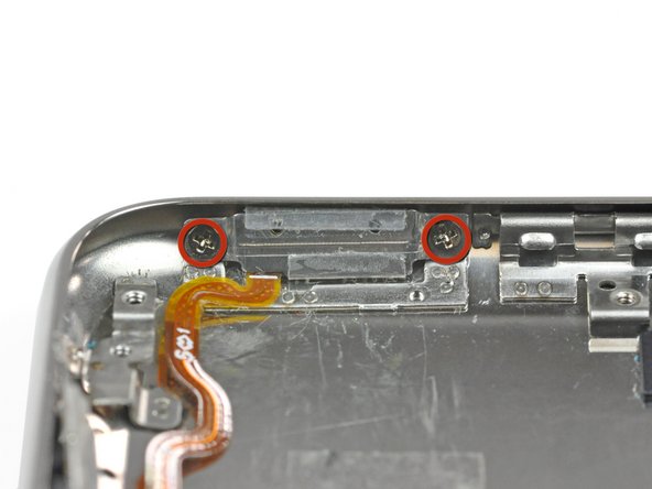

Add Note Edit Step 35  ¶
  • Lift the power/volume controls out of the rear panel.

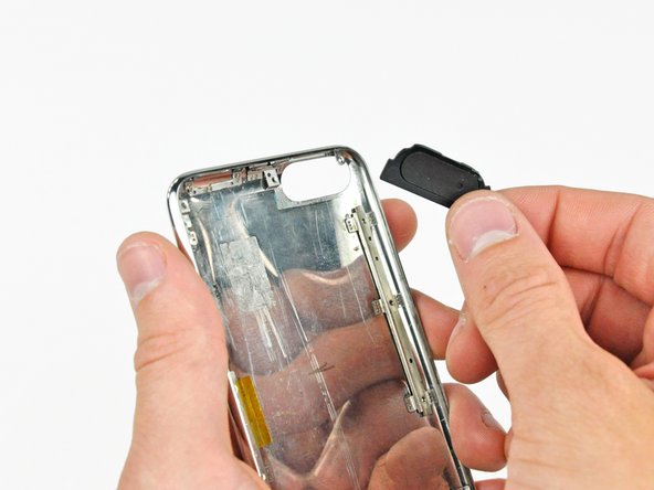

Add Note Edit Step 36 — Rear Panel  ¶
  • Use your finger to push the plastic antenna window through the other side of the rear panel.
  • Remove the plastic antenna window from the rear panel.

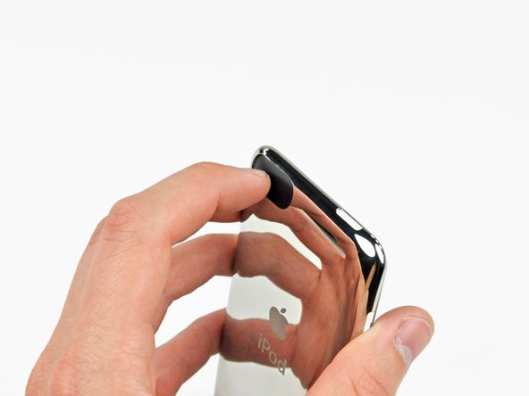

Image #1
Add Note Edit Step 37  ¶
  • Use the flat end of a spudger to pry the protective rubber grommet from the bottom left hand corner of the rear panel.
