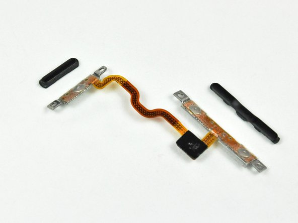

Add Note Edit Step 33 — Power/Volume Controls  ¶
  • Remove the two Phillips screws securing the power/volume controls to the rear panel.
Image #1
Add Note Edit Step 34  ¶
  • Use the tip of a spudger to remove the yellow kapton tape covering the power/volume control ribbon cable.
Image #1
Add Note Edit Step 35  ¶
  • Lift the power/volume controls out of the rear panel.
Image #1
Add Note Edit Step 36 — Power/Volume Controls Replacement  ¶
  • Power/Volume controls remain.
