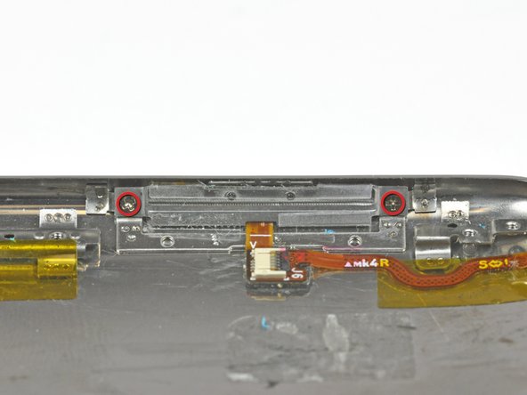

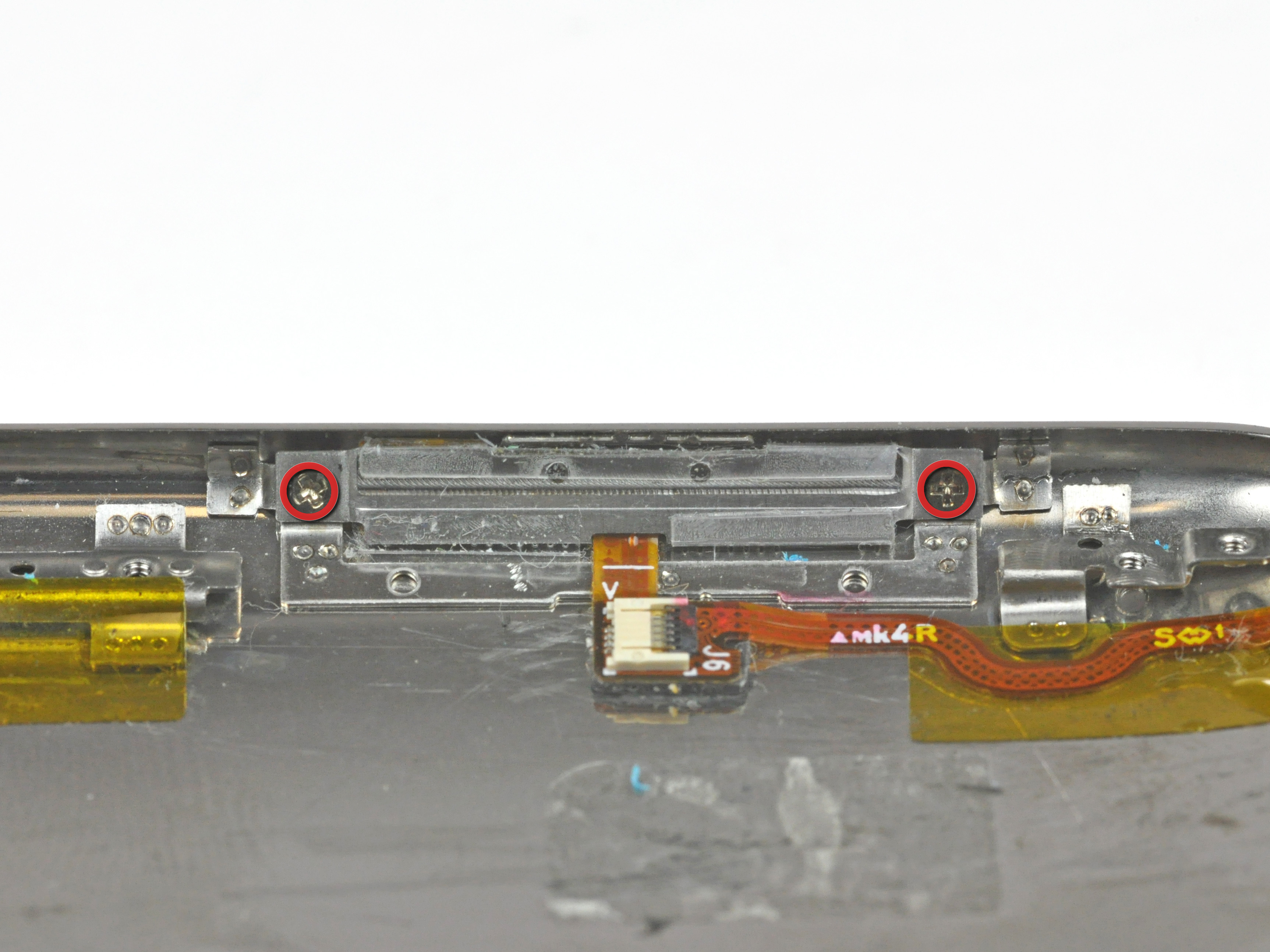

Add Note Edit Step 1 — Power/Volume Controls  ¶
  • Remove the two Phillips screws securing the power/volume controls to the rear panel.

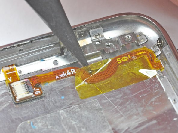

Add Note Edit Step 2  ¶
  • Use the tip of a spudger to remove the yellow kapton tape covering the power/volume control ribbon cable.

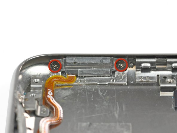

Add Note Edit Step 3  ¶
  • Lift the power/volume controls out of the rear panel.
