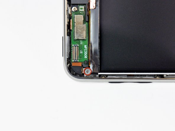

Add Note Edit Step 1 — Front Panel  ¶
  • The glass front panel on the second generation Touch has a plastic frame glued both to its outer edge and also under the wide black strips at the top and bottom of the device. The frame also has a rubber strip that surrounds the edge of the glass panel.
  • The picture at left (front panel already removed) shows the locations of the metal clips (shown in red) that snap on to the plastic frame. In the next few steps, try to pry the front panel up from the gaps between these clips.
  • Also, be mindful of the very thin and delicate touch screen ribbon cable (connector location shown in orange) attaching the front panel to the upper left corner of the Touch.

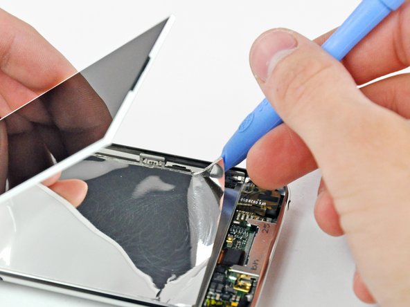

Add Note Edit Step 8  ¶
  • Use the flat end of a spudger (or an opening tool) to pry the touch screen cable connector up off the upper logic board.
  • Now that the front panel is out, check it for damage. If the plastic surround is not flush with the front face of the glass panel, gently peel it off and stick it down.
  • Be careful not to scratch the front panel on the underside of the black portions, as the scratches will be visible once the device is reassembled.
  • Be sure to clean both the face of the display and the inner surface of the front panel, as any dust or fingerprints will be trapped inside the Touch once it is fully reassembled.

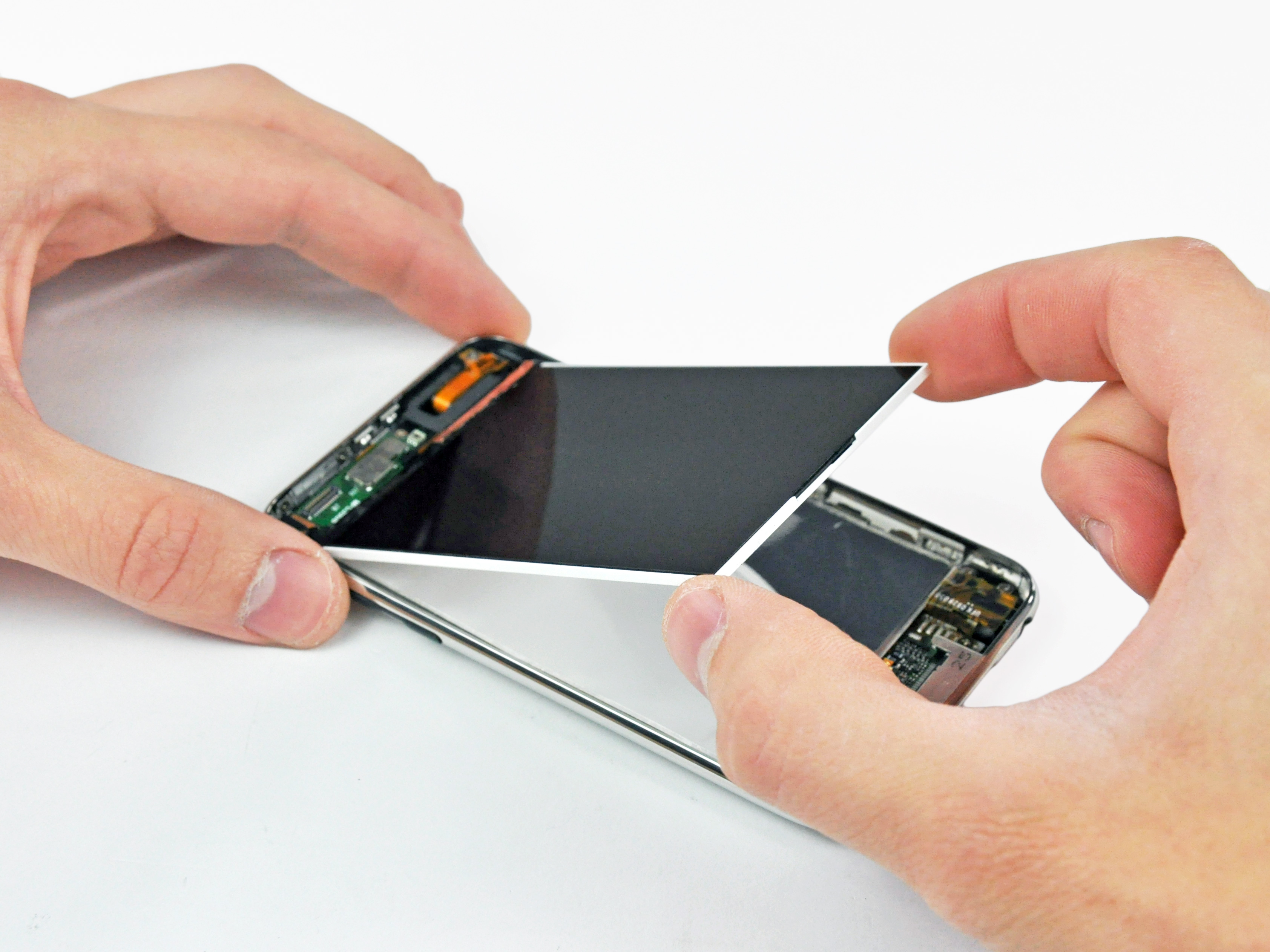

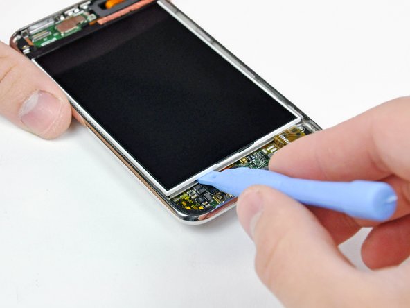

Add Note Edit Step 9 — Display  ¶
  • Insert a small iPod opening tool with the edge angled up toward the underside of the display between the white plastic backlight and the metal shield beneath it.
  • Pry up along the lower edge of the display enough to grab it with your fingers.
Image #1

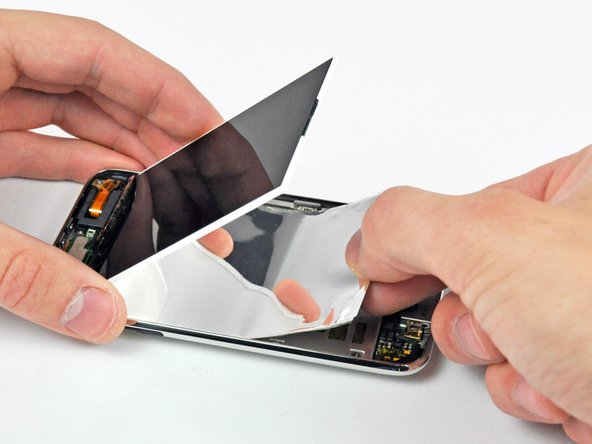

Add Note Edit Step 11  ¶
  • While holding the display with one hand, run an iPod opening tool down the two long edges of the mylar reflector attached to the metal display tray.
  • When it is sufficiently free from the display tray, remove the mylar reflector from the Touch.

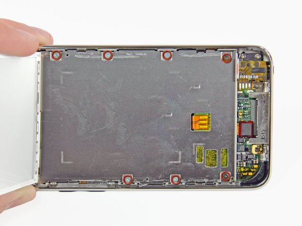

Add Note Edit Step 12  ¶
  • Remove the seven Phillips screws securing the metal display tray to the rear panel.
  • The two darker screws belong in the two holes in the tray nearest the bottom edge of the Touch.
Image #1

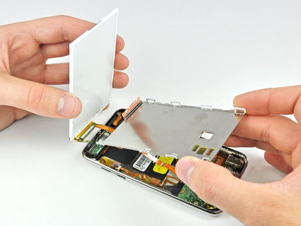

Add Note Edit Step 14  ¶
  • Lift the display out of the metal tray and rotate it toward the top edge of the Touch.
  • Use an iPod opening tool to lift the metal display tray and rotate it up toward the top edge of the Touch.
Image #1

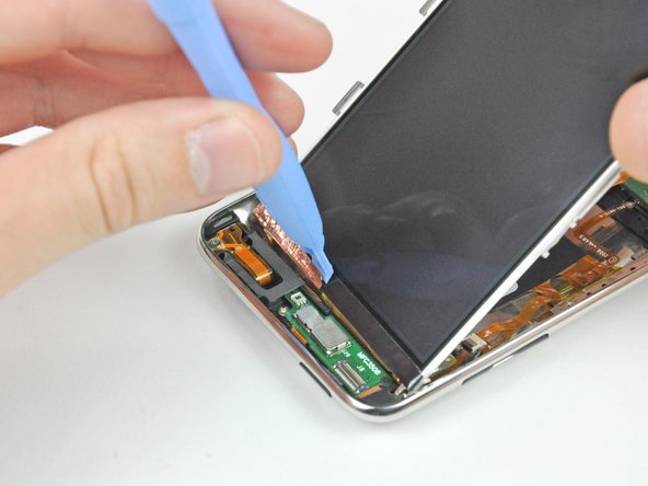

Add Note Edit Step 15  ¶
  • Use the edge of an iPod opening tool to peel the copper tape off the top edge of the display.
  • Leave the copper tape attached to the metal display tray.

Add Note Edit Step 17  ¶
  • Lift the metal display tray slightly (the battery is attached to its underside) and remove the display from the Touch, minding its delicate cable that may get caught.
  • The display ribbon cable is routed under the metal display tray.
