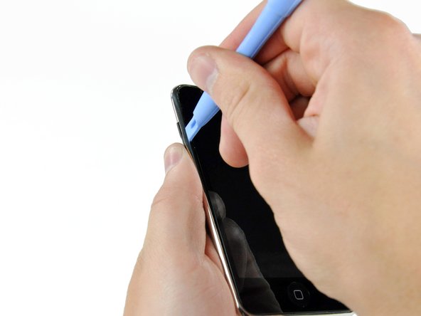

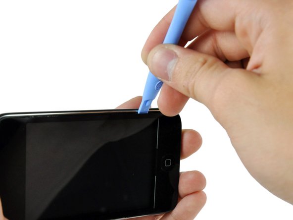

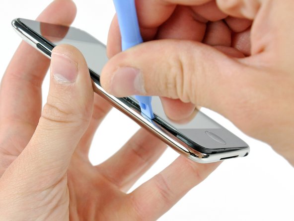

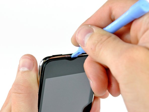

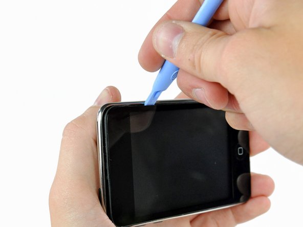

The picture at left (front panel already removed) shows the locations of the metal clips (shown in red) that snap on to the plastic frame. In the next few steps, try to pry the front panel up from the gaps between these clips.

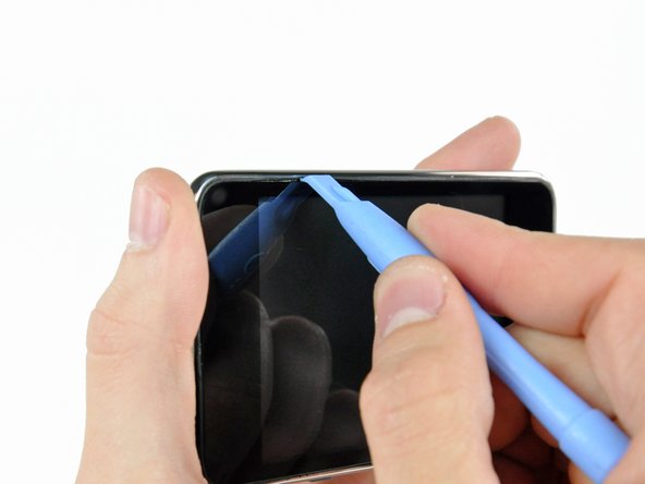

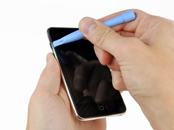

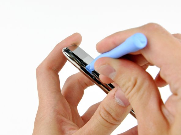

Insert a small iPod opening tool with the edge angled up toward the underside of the display between the white plastic backlight and the metal shield beneath it.

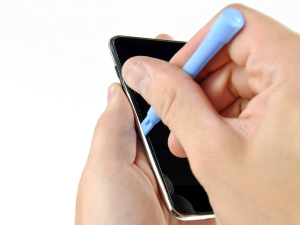

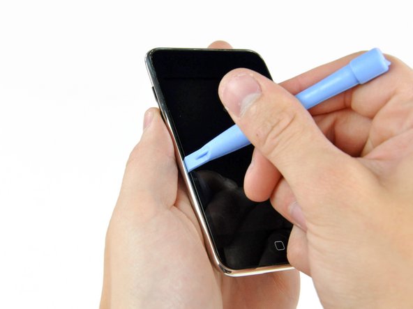

Pry up along the lower edge of the display enough to grab it with your fingers.

Somehow it always get left out of these tutorals that the !@#$ thing has ALL parts glued together! There's a thin layer of what looks like silicon sealant/glue between the glass and the metal shell. Then the LCD is glued (also with silicon) to mylar backing and mylar backing is glued to the metal frame. The battery is also glued to that frame. The glue gives if you're persistent but it's very easy to crack the LCD while trying to pry it from the metal frame and I had to literally cut the battery off of the other side of that frame.
Having successfully changed several iPhone batteries I decided to replace the cracked glass on my 2nd Gen Touch but it's practically impossible to do without damaging the rest of the iPod. With 2nd hand values as they are now in 2022 it's actually cheaper to buy a decent second hand 3rd. Gen one than it cost to buy the new screen, mid-frame & glue to repair the original.!! Not my ideal as I wanted to repair the old one, but at least I'm making use of another iPod that the previous owner no longer wanted. I have no doubt that these are repairable but a great deal of care & experience / practice is required & mine ended up being scrapped :-(
