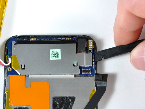

Add Note Edit Step 8  ¶
  • Use the spudger to remove the black masking tape. This will reveal the top two screws in the picture.
  • Unscrew the four Phillips screws.
  • Use a spudger to disconnect the black connector.
Image #1 Image #2

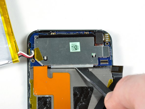

Add Note Edit Step 9  ¶
  • Use the spudger to loosen the logic board from multiple sides. It is held in place by glue and the four screws that were removed in the previous step.
Image #1 Image #2 Image #3

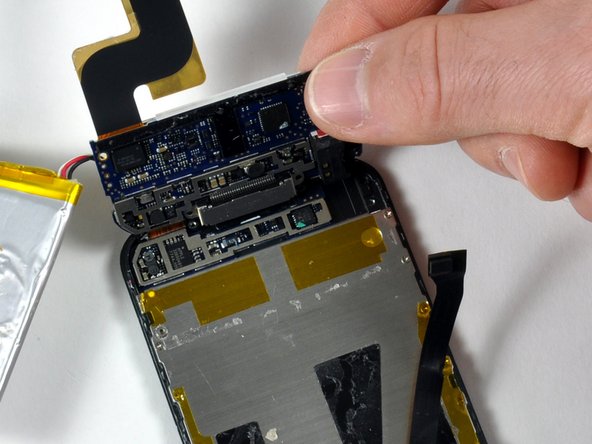

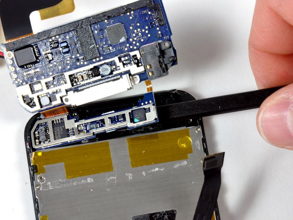

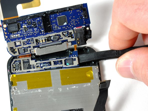

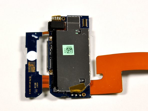

Add Note Edit Step 10  ¶
  • Be careful when flipping up the logic board. The headphone jack and docking port are attached to the board.
  • Gently lift the logic board (and attached components) upward.
  • The smaller portion of the logic board that resides underneath is very bendable and frail. Make sure not to pull the spudger upward when using it to detach the small board. Use only side-to-side movement.
  • Slide the spudger under the small portion of the logic board. The board should come loose once the spudger has slid almost all the way to the other side.
Image #1

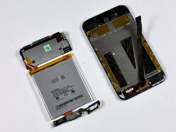

Add Note Edit Step 11  ¶
  • The logic board and battery can now be fully separated from the rest of the iPod.
Image #1

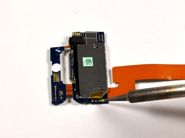

Add Note Edit Step 12 — Battery  ¶
  • Use the tip of a spudger to remove the cloudy white glue covering the battery contacts.
Image #1

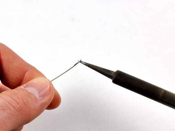

Add Note Edit Step 13  ¶
  • We're now ready to begin the soldering process. You'll need a soldering iron, solder, and desoldering wick. You should be able to find these items at a Radio Shack if you don't already have them.
  • Clean the soldering iron by melting a small amount of solder directly onto the soldering iron's tip and then wiping the tip of the soldering iron on a damp sponge.
Image #1

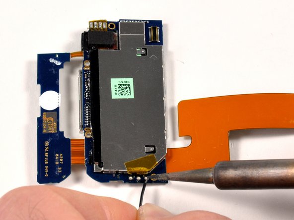

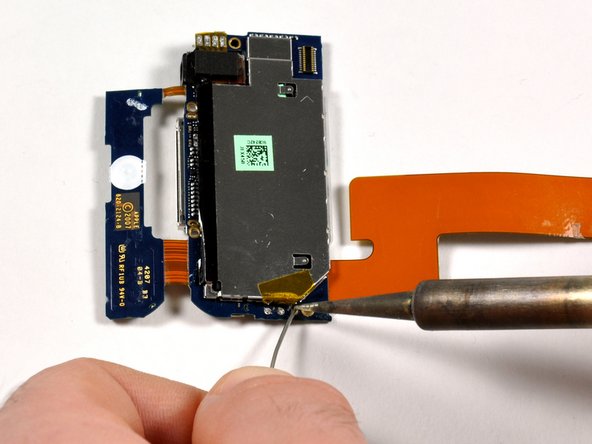

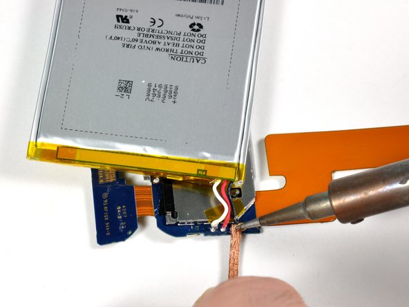

Add Note Edit Step 14  ¶
  • Place the desoldering wick on top of the existing solder ball.
  • Place the soldering iron on top of wick above the existing solder ball.
  • Hold the soldering iron in place until the solder melts into the wick.
  • Repeat the same procedure on the remaining two connectors.
  • Lift the old battery out of the iPod. Be sure that all the solder has been removed before pulling the wires away from the board. The wires should come free with little to no resistance.
