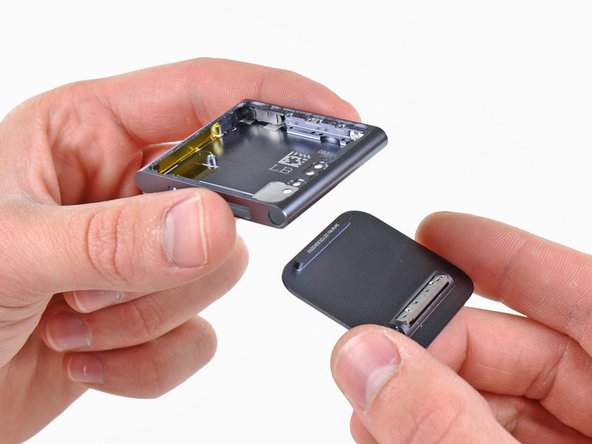

Image #1
Add Note Edit Step 17  ¶
  • Remove the clip from the outer case.
  • Outer case remains.
  • When reinstalling the clip, it is necessary to squeeze the base of the clip very tightly against the outer case as you insert the first screw.
