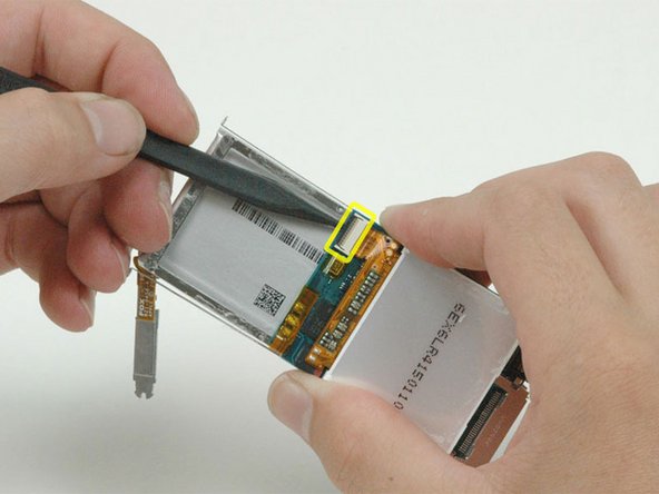

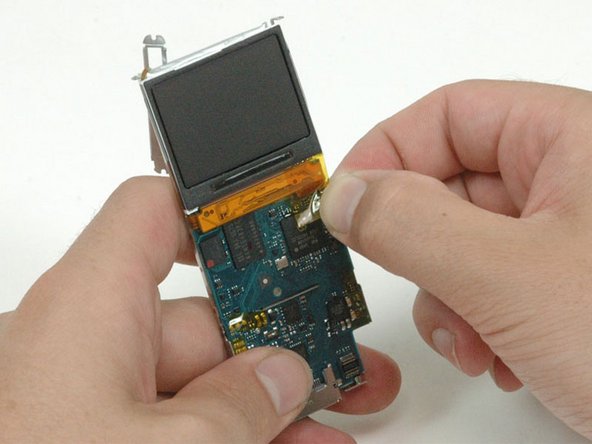

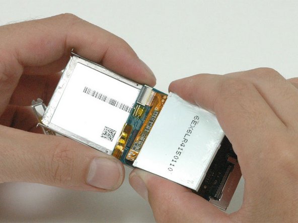

Image #1
Add Note Edit Step 17  ¶
  • Peel up the orange tape covering the display ribbon cable.
Image #1
Add Note Edit Step 18  ¶
  • Use a spudger to flip up the black plastic tab holding the orange display ribbon in place. The tab will rotate up 90 degrees, releasing the ribbon cable.
Image #1
Add Note Edit Step 19  ¶
  • Slide the display ribbon out of its connector and lift the display off of the logic board.
