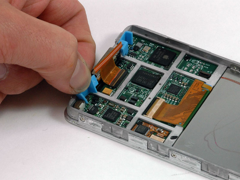

Add Note Edit Step 25  ¶
  • Slide the orange hard drive ribbon cable directly out of its connector.
  • If you are replacing the hard drive in your iPod and it did not come with the rubber mounting brackets and foam padding, transfer these items from your old drive to the replacement drive.
Image #1
Add Note Edit Step 26 — Rubber Bumpers  ¶
  • Carefully pull each rubber bumper up and away from the framework.
