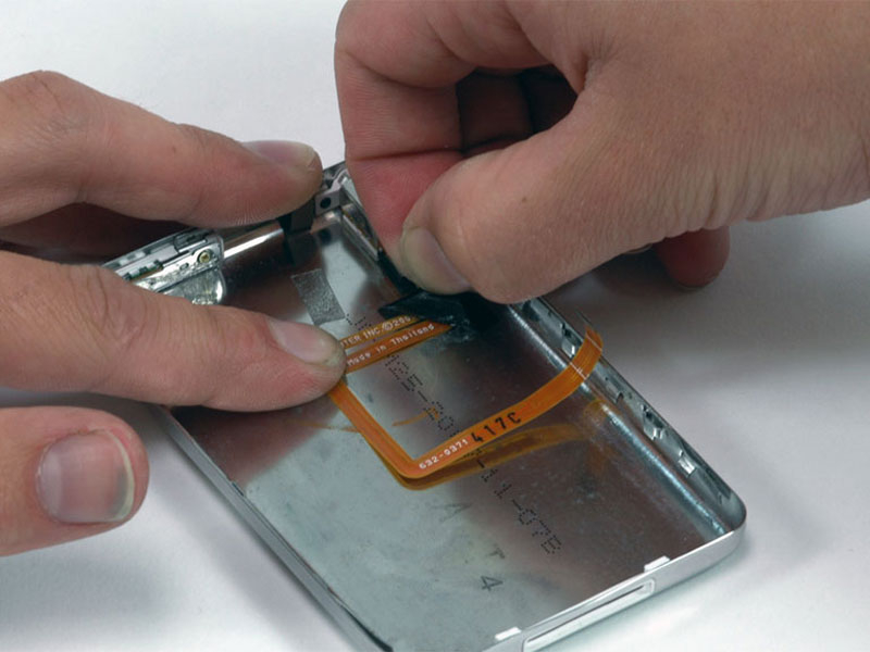

  25. iPod Classic Headphone Jack & Hold Switch Replacement, Headphone Jack & Hold Switch: step 25, image 1 of 1
    • Use one hand to hold the orange ribbon cables in place, and peel up the black tape securing the cables to the rear panel with your other hand.
