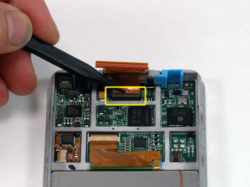

  • Apple designed their new iPods to be very difficult to take apart without destroying major components. Because of the metal faceplate, the metal backing, and the 13 (yes, 13) metal clips holding the case together, this is one of the toughest iPods to disassemble. Proceed with caution and the warning that you may significantly damage your iPod beyond its present condition. Also, you may want a few extra pairs of iPod opening tools during installation, as they are easy to ruin when opening the iPod. Have fun!
  • Before opening your iPod, ensure that the hold switch is in the locked position.
Image #1
Add Note Edit Step 2  ¶
  • Opening this iPod is challenging. Don't get discouraged if it takes you a few tries before the iPod is opened. One thing to notice is the angle of the plastic iPod opening tool's tip while inserting it into the iPod. Ideally, the angle should be as vertical as possible while still clearing the edge of the rear panel.
  • Insert a plastic iPod opening tool into the seam between the front and back of the iPod.
Image #1
Add Note Edit Step 3  ¶
  • Insert another plastic iPod opening tool into the seam between the front and back of the iPod, leaving at least 1.5 inches of space between the two tools.
Image #1
Add Note Edit Step 4  ¶
  • At an angle, carefully insert a putty knife about 1/8 inch into the seam between the two opening tools.
  • There are thin metal rails running along the inside of the rear panel, so take great care when inserting the putty knife.
  • Once the putty knife has cleared the lip of the rear panel, pivot the putty knife so that it is vertical, and carefully (but firmly) wiggle it straight down into the gap between the iPod opening tools.
Image #1
Add Note Edit Step 5  ¶
  • Push with your fingers on the rear panel behind the putty knife to minimize bending. Slowly flex the putty knife, as shown in the picture, to ensure that most of the metal tabs on this side of the iPod are disengaged.
  • The theory behind this method is, rather than attempting to not bend the rear panel at all, to bend it in a favorable manner that allows you to easily restore it later. Therefore, any bend in the sides of the rear panel should be drawing the lip of the rear panel away from the iPod, rather than pushing out on the curved surface. This method also disengages as many of the side clips as possible.
Image #1
Add Note Edit Step 6  ¶
  • Remove the putty knife from the iPod and reinsert it closer to the corner of the iPod, using the same wiggle method as before.
  • If at all possible, do not bend the corner of the rear panel.
Image #1
Add Note Edit Step 7  ¶
  • Near the headphone jack, insert an iPod opening tool into the seam between the front and back of the iPod.
  • You may find it easier to carefully flex the putty knife downward in order to create more of a gap for the iPod opening tool, but be sure not to bend the corner of the rear panel!
Image #1
Add Note Edit Step 8  ¶
  • Near the center of the display, carefully insert a metal spudger into the gap created by the iPod opening tool.
  • It is easy to create a noticeable bump in the rear panel here that is difficult to repair. When prying the tab free, try to have the metal spudger pivot on the edge of the rear panel rather than bending the rear panel outward.
  • Using the metal spudger, disengage the single clip on the top of the iPod.
