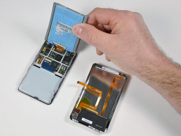

Add Note Edit Step 9  ¶
  • With the iPod opening tool, gently lift the brown tab of the headphone ribbon cable connector. The tab will rotate up 90 degrees, releasing the ribbon cable.
  • Using your fingers, pull out the headphone jack ribbon cable.
Image #1
Add Note Edit Step 10  ¶
  • The front and back of the iPod should now be completely separated.
Image #1 Image #2
Add Note Edit Step 11 — Hard Drive  ¶
  • Use a small iPod opening tool to release the black hinge holding the hard drive ribbon cable. The tab will rotate up 90 degrees towards the logic board, releasing the ribbon cable.
  • Use your forefinger to hold the ribbon cable in place; disconnect the drive from the ribbon cable.
  • Make sure the hard drive rubber side bumpers are attached to the drive being installed. Use the hard drive rubber side bumper installation guide to accomplish this task.
  • If necessary, the blue foam padding on the hard drive might also need to be transferred to the replacement drive.
