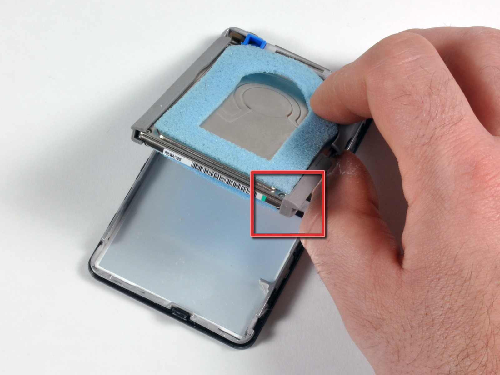

Add Note Edit Step 11 — Hard Drive  ¶
  • Use a small iPod opening tool to release the black hinge holding the hard drive ribbon cable. The tab will rotate up 90 degrees towards the logic board, releasing the ribbon cable.
  • Use your forefinger to hold the ribbon cable in place; disconnect the drive from the ribbon cable.
  • Make sure the hard drive rubber side bumpers are attached to the drive being installed. Use the hard drive rubber side bumper installation guide to accomplish this task.
  • If necessary, the blue foam padding on the hard drive might also need to be transferred to the replacement drive.
Image #1 Image #2 Image #3
Add Note Edit Step 12 — Side Bumpers  ¶
  • The rubber side bumpers should be installed as pictured:
    • The side of the drive that's being propped by the hard drive holding bracket should have the rubber side bumper that has a sidewall on the corner, as indicated by the red box.
    • There should be a space in between the two smaller rubber side bumpers, as indicated by the yellow box.
    • Both sides of the drive should be seated snugly, as shown in the third picture.
