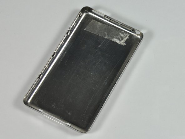

Add Note Edit Step 17  ¶
  • Use the small iPod opening tool to carefully peel the orange ribbon cable and attached black Hold switch up from the metal backing.
  • When re-attaching the replacement Hold switch, make sure the two small posts on the back of the switch are aligned with the two holes in the metal backing.
Image #1
Add Note Edit Step 18 — Rear Panel  ¶
  • You are now able to replace the rear panel of the iPod.
