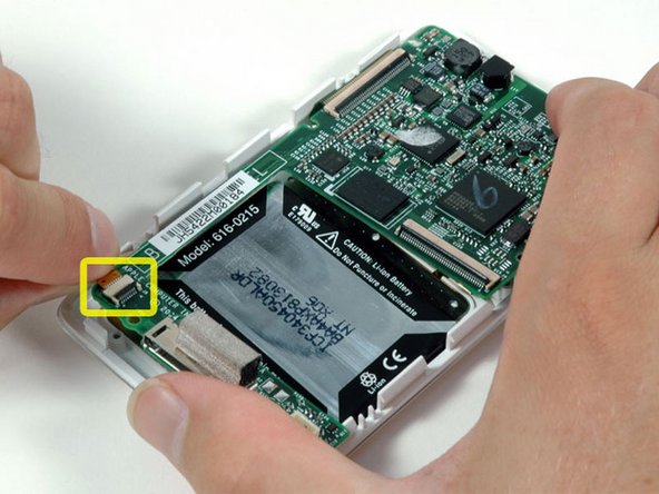

Add Note Edit Step 7  ¶
  • The iPod case is now open, but don't separate the two halves just yet. There is still an orange ribbon cable connecting the headphone jack to the logic board.
  • Open the case like a book with the dock connector edge at the top, and lay the rear panel next to the front half of the iPod.
Image #1
Add Note Edit Step 8  ¶
  • Use a plastic tool or your fingernails to carefully disconnect the orange headphone jack cable. Be sure to pull straight up on the connector, not the cable itself.
Image #1
