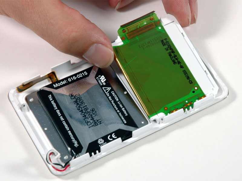

  14. iPod 4th Generation or Photo Display Replacement, Display: step 14, image 1 of 1
    • Lift the display panel out of the iPod. There may be some mild adhesive connecting the display to the front panel.
