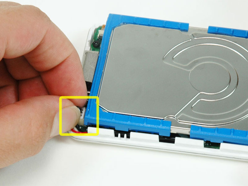

Add Note Edit Step 9 — Battery  ¶
  • Carefully disconnect the white battery connector from the logic board. Be sure to pull only on the connector itself and not on the cables.
Image #1

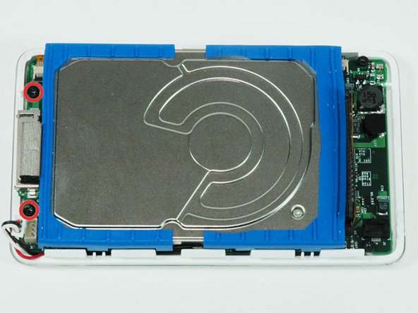

Add Note Edit Step 10  ¶
  • Remove the 2 black T6 Torx screws from the left side of the logic board.
Image #1
