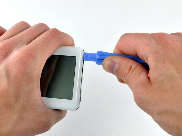

Add Note Edit Step 2  ¶

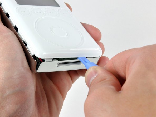

  • Opening the case can be challenging. Do not get discouraged if it takes you a few tries before the iPod is opened.
  • Insert a large iPod opening tool into the seam between the plastic front and metal rear panel of the iPod, near the headphone jack. The tool's edge should point toward the metal rear panel to prevent any accidental scratching of the plastic front.
  • Run the tool along the top seam toward the upper left corner of the iPod.

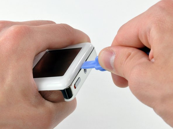

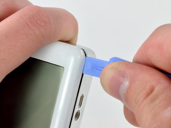

Add Note Edit Step 3  ¶
  • Push the large iPod opening tool into the upper left corner of the iPod, creating a small gap along the side seam.
Image #1 Image #2

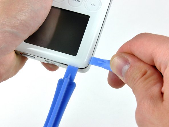

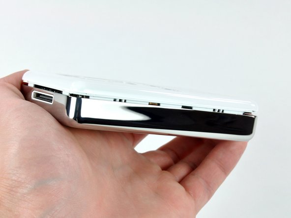

Add Note Edit Step 4  ¶
  • There are five retaining tabs on each side of the iPod.
  • With the large iPod opening tool still inserted in the top seam, press a small iPod opening tool into the gap you just created.
  • Run the iPod opening tool down the side seam, releasing all five tabs.
  • It may be necessary to wiggle the tool while working your way down the seam to free all the tabs.

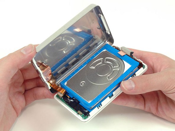

Add Note Edit Step 6  ¶
  • The iPod case is now open, but don't separate the two halves just yet. There is still an orange ribbon cable connecting the headphone jack to the logic board.
  • Open the case like a book with the dock connector at the top, and lay the rear panel next to the front half of the iPod.

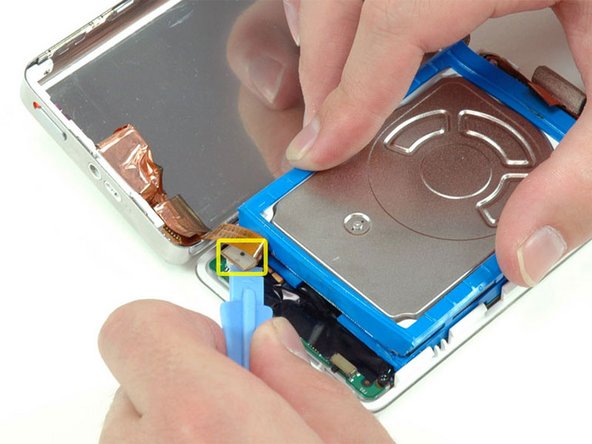

Add Note Edit Step 7  ¶
  • Use a plastic tool or your fingernails to carefully disconnect the orange headphone jack cable. Be sure to pull straight up on the connector, not the cable itself.

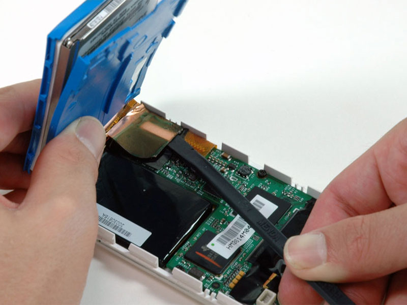

Add Note Edit Step 8 — Hard Drive  ¶
  • Lift up the hard drive with one hand and carefully disconnect the hard drive ribbon from the logic board.
  • Lift the hard drive out of the iPod.

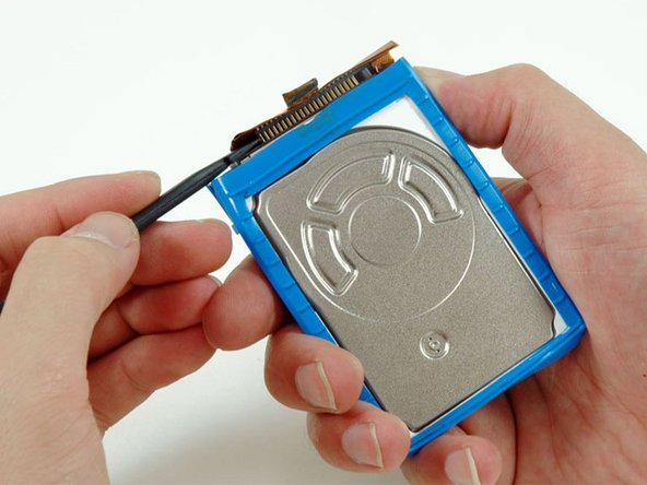

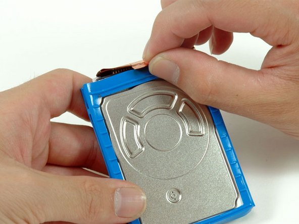

Add Note Edit Step 9  ¶
  • Peel back the metallic tape connecting the hard drive ribbon to the blue mounting bracket.
Image #1
Add Note Edit Step 10  ¶
  • Use a spudger to carefully disconnect the orange ribbon cable from the hard drive.
  • If the cable doesn't come free easily, it may be helpful to gently wiggle the cable from side to side.

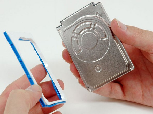

Add Note Edit Step 12  ¶
  • Lift the blue and white mounting bracket off the other side of the hard drive.
Image #1

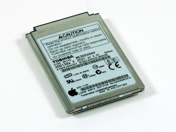

Add Note Edit Step 13  ¶
  • Hard drive remains.
