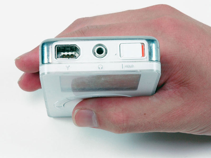

  • Before opening your iPod, ensure that the hold switch is in the locked position.
Image #1
Add Note Edit Step 2  ¶
  • Opening the iPod can be challenging; don't get discouraged if it takes you a few tries to get the iPod to open.
  • Insert a plastic iPod opening tool in the seam between the white plastic front and metal back of the iPod. Once you've inserted the tool, run it along the seam to free the five tabs holding the iPod together.
Image #1
Add Note Edit Step 3  ¶
  • Continue to run the opening tool along the side of the case until all five tabs have been released.
Image #1
Add Note Edit Step 4  ¶
  • Work around the corner of the iPod and release the two tabs holding the iPod together near the dock connector.
Image #1
Add Note Edit Step 5  ¶
  • Free the five tabs holding the iPod together on the other side. You may be able to free the tabs by gently wiggling the front panel of the iPod.
  • Lift the rear panel away from the iPod.
