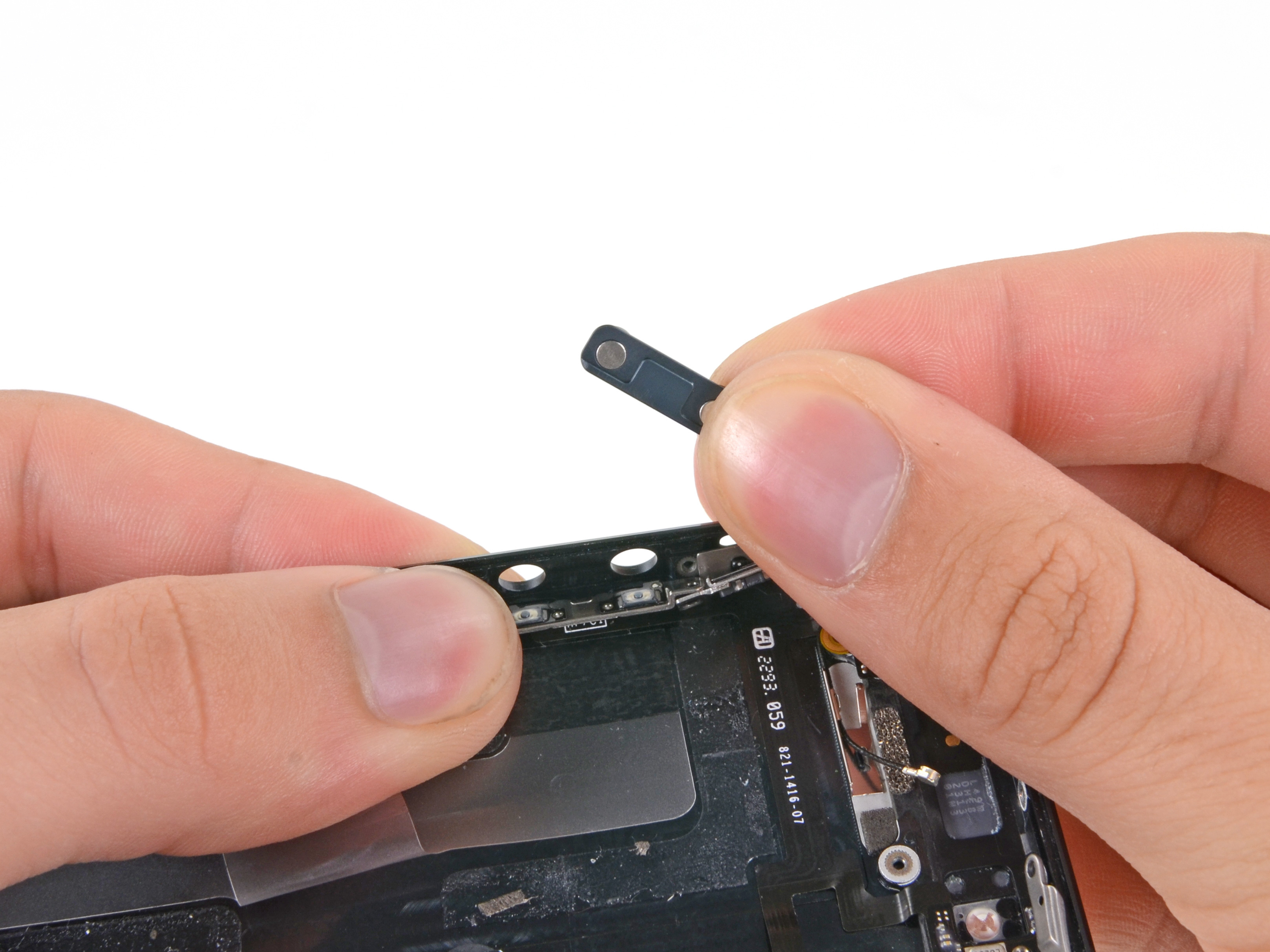

  20. iPhone 5 Volume Controls Replacement, Volume Controls: step 20, image 1 of 1
    • Remove the following screws securing the volume button and ringer switch brackets to the side of the rear case:
    • One 1.5 mm Phillips screw
    • Two 1.8 mm Phillips screws
  21. iPhone 5 Volume Controls Replacement: step 21, image 1 of 3 iPhone 5 Volume Controls Replacement: step 21, image 2 of 3 iPhone 5 Volume Controls Replacement: step 21, image 3 of 3
    • Use the tip of a spudger to pry the ringer switch bracket from the side of the rear case.
    • Remove the ringer switch.
  22. iPhone 5 Volume Controls Replacement: step 22, image 1 of 2 iPhone 5 Volume Controls Replacement: step 22, image 2 of 2
    • Use a spudger to pry the volume button bracket from the side of the rear case.
    • Remove the volume buttons.
