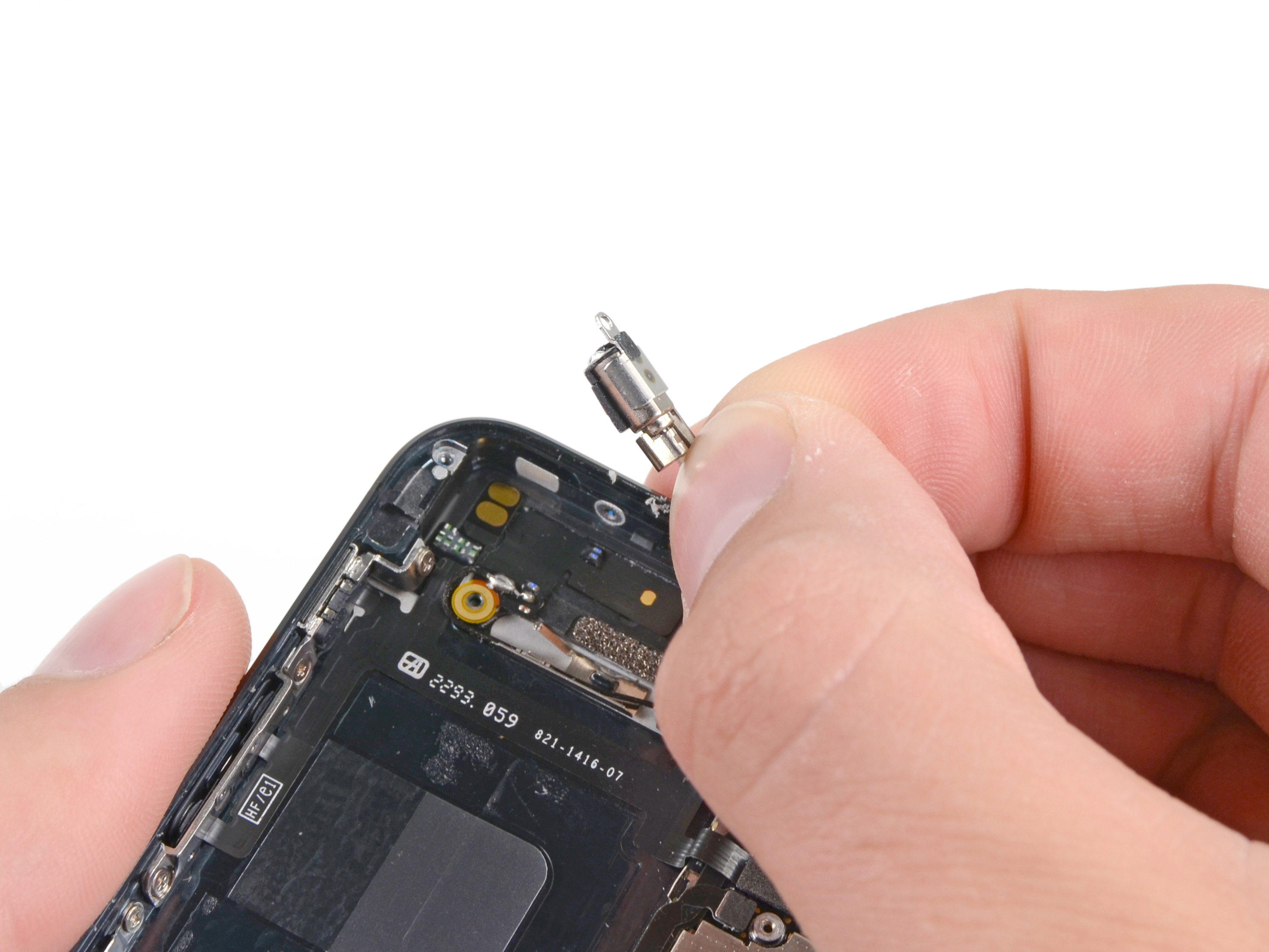

  20. iPhone 5 Vibrator Replacement, Vibrator: step 20, image 1 of 1
    • Remove two screws securing the vibrator bracket to the rear case:
    • Single 2.3 mm Phillips screw
    • Single 1.7 mm Phillips screw
  21. iPhone 5 Vibrator Replacement: step 21, image 1 of 1
    • Remove the vibrator bracket from the rear case.
  22. iPhone 5 Vibrator Replacement: step 22, image 1 of 1
    • Remove the 1.6 mm Phillips screw securing the vibrator to the top inside of the rear case.
  23. iPhone 5 Vibrator Replacement: step 23, image 1 of 2 iPhone 5 Vibrator Replacement: step 23, image 2 of 2
    • Remove the vibrator from the rear case.
