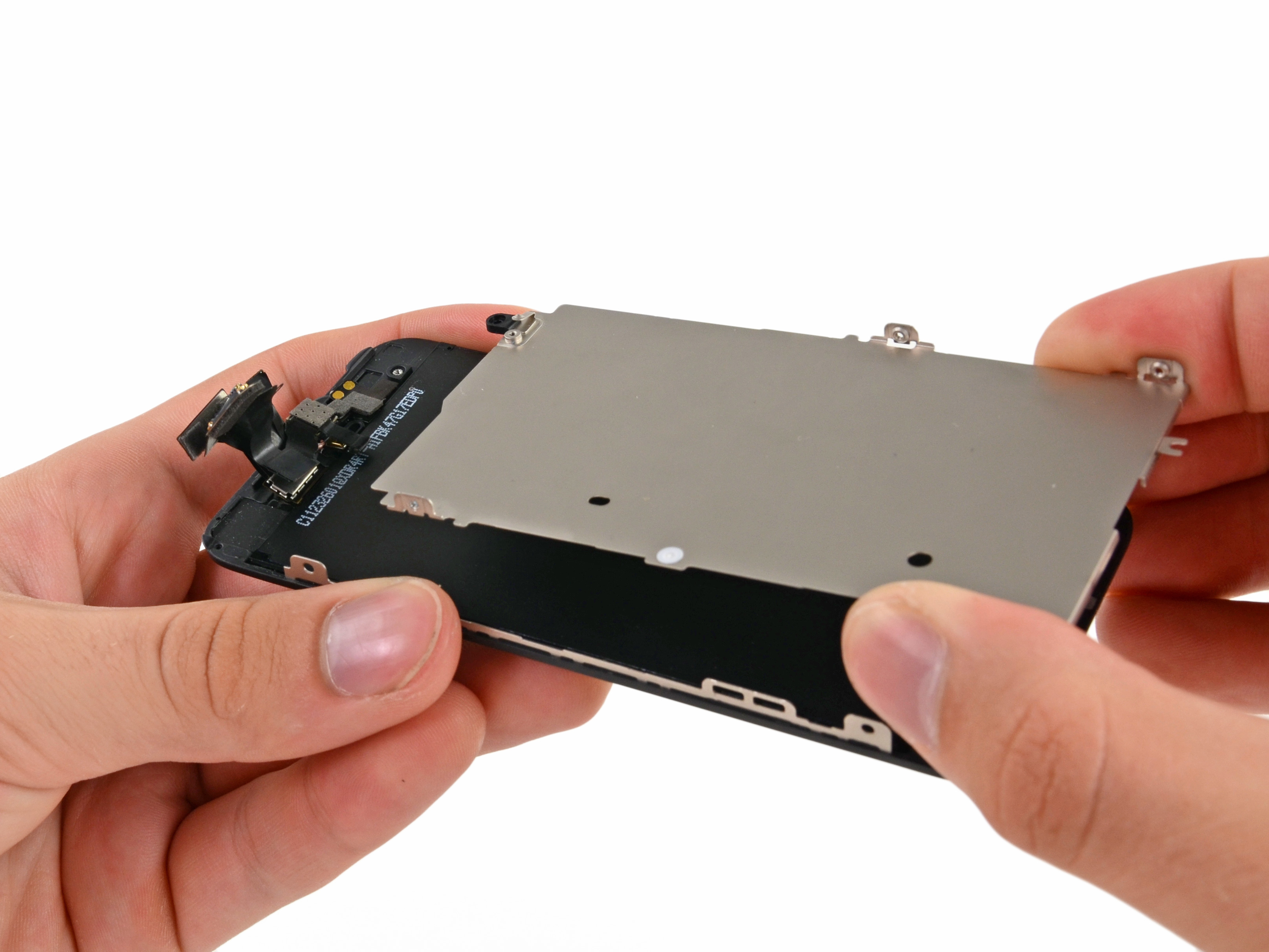

  17. iPhone 5 LCD Shield Plate Replacement, LCD Shield Plate: step 17, image 1 of 2 iPhone 5 LCD Shield Plate Replacement, LCD Shield Plate: step 17, image 2 of 2
    • Remove two 1.2 mm Phillips screws from each side of the LCD frame (four total).
  18. iPhone 5 LCD Shield Plate Replacement: step 18, image 1 of 1
    • Remove the following two screws securing the LCD shield plate to the display assembly:
    • Single 2.6 mm Phillips screw
    • Single 1.4 mm Phillips screw
  19. iPhone 5 LCD Shield Plate Replacement: step 19, image 1 of 2 iPhone 5 LCD Shield Plate Replacement: step 19, image 2 of 2
    • Remove the LCD shield plate from the display assembly.

On Steps 17 and 18 you somehow magically removed the ear speaker/ ff camera bracket. You do need to remove that before you can take the lcd plate off.
Damon - Reply
Still have not corrected the missing instructions involving removing the earpiece speaker… magical
Ethan LaMoure - Reply
