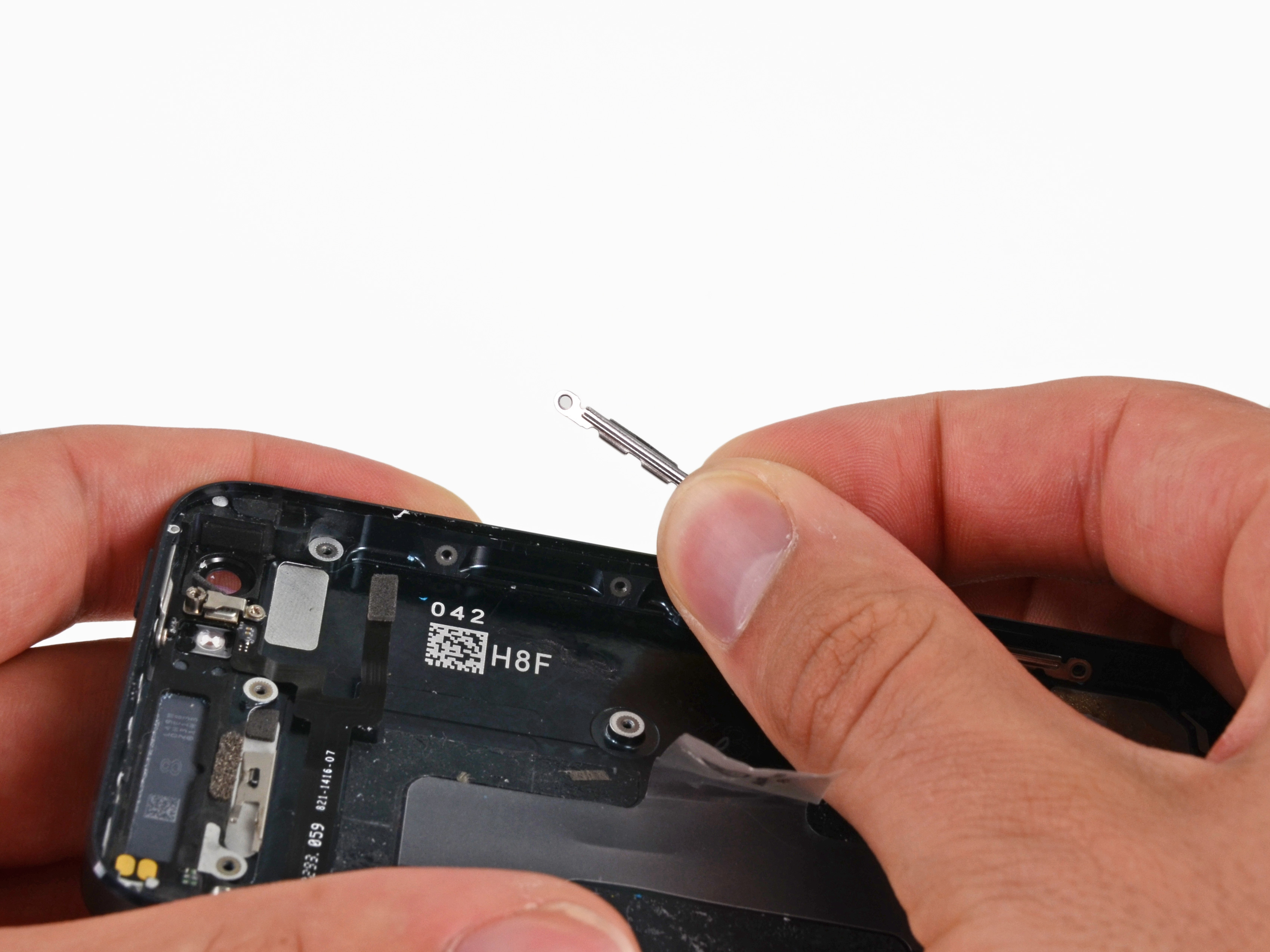

The display assembly is secured to the rear case with four rubber-padded metal clips. Use this guide to replace one or more of these clips.

  • Once the clips have been released on the bottom and sides of the front panel assembly, pull the bottom of the assembly away from the rear case.
  • Do not try to completely remove the front panel assembly from the rear case, as there are several ribbon cables still attached at the top of the iPhone.
  • Lift and rotate the front panel assembly up to about 90 degrees from the rear case.
