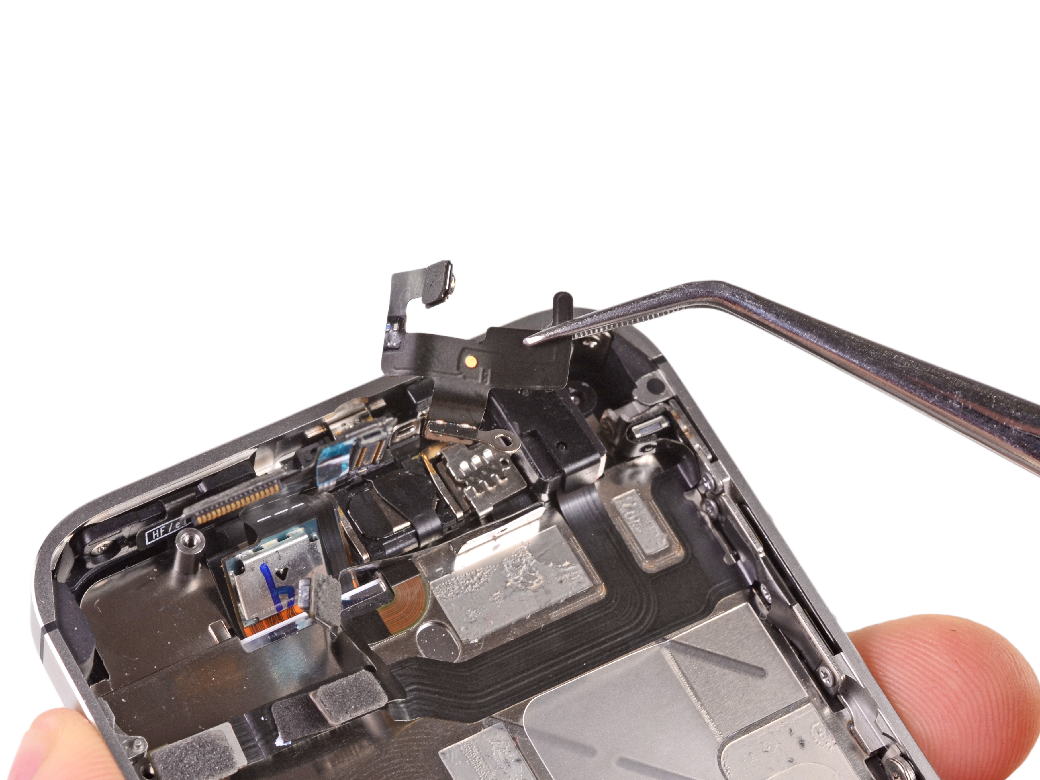

  28. iPhone 4S Upper Antenna Replacement, Upper Antenna: step 28, image 1 of 1
    • Remove the 2.4 mm Phillips screw next to the headphone jack.
  29. iPhone 4S Upper Antenna Replacement: step 29, image 1 of 2 iPhone 4S Upper Antenna Replacement: step 29, image 2 of 2
    Tool used on this step:
    Buy
    • Use the edge of a plastic opening tool to peel the upper antenna off the headphone jack.
    • Use a pair of tweezers to remove the upper antenna from the iPhone.
    • Before reassembly, be sure to clean the metal-to-metal contact point on the upper antenna (not the mating halves of its connector) with a de-greaser such as windex or isopropyl alcohol. The oils on your fingers have the potential to cause wireless interference issues.
