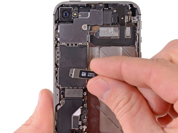

  14. iPhone 4S Speaker Enclosure Replacement: step 14, image 1 of 1
    • Remove the two 2.4 mm Phillips screws securing the speaker enclosure assembly to the outer case.
  15. iPhone 4S Speaker Enclosure Replacement: step 15, image 1 of 1
    • Remove the small black spacer that was under the Phillips screw near the vibrator.
