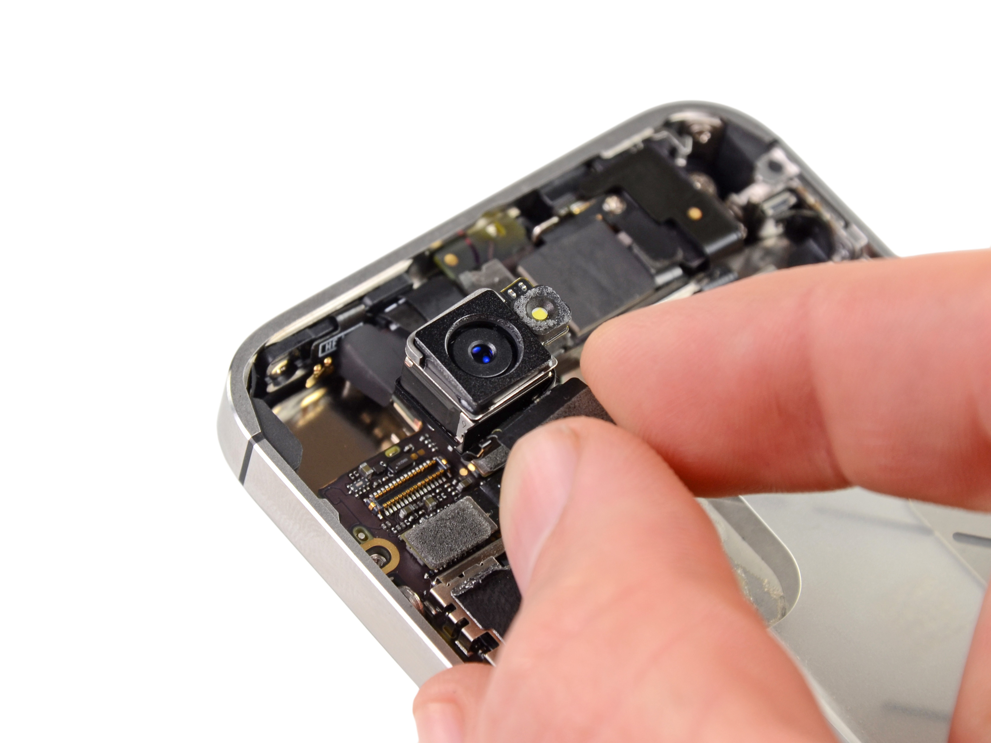

Introduction
Use this guide to remove the iPhone's primary rear camera.
Power off your iPhone before beginning disassembly.
Remove the two 3.6 mm Pentalobe P2 screws next to the dock connector.
Remove the following screws securing the battery connector to the logic board:
One 1.7 mm Phillips screw (PH00)
One 1.5 mm Phillips screw (PH00)
Insert the edge of a plastic opening tool between the battery and the outer case near the bottom of the iPhone.
Run the plastic opening tool along the right edge of the battery and pry up at several points to completely separate it from the adhesive securing it to the outer case.
Wait about one minute for the alcohol solution to weaken the adhesive.
Use the flat end of a plastic opening tool to gently lift the battery.
