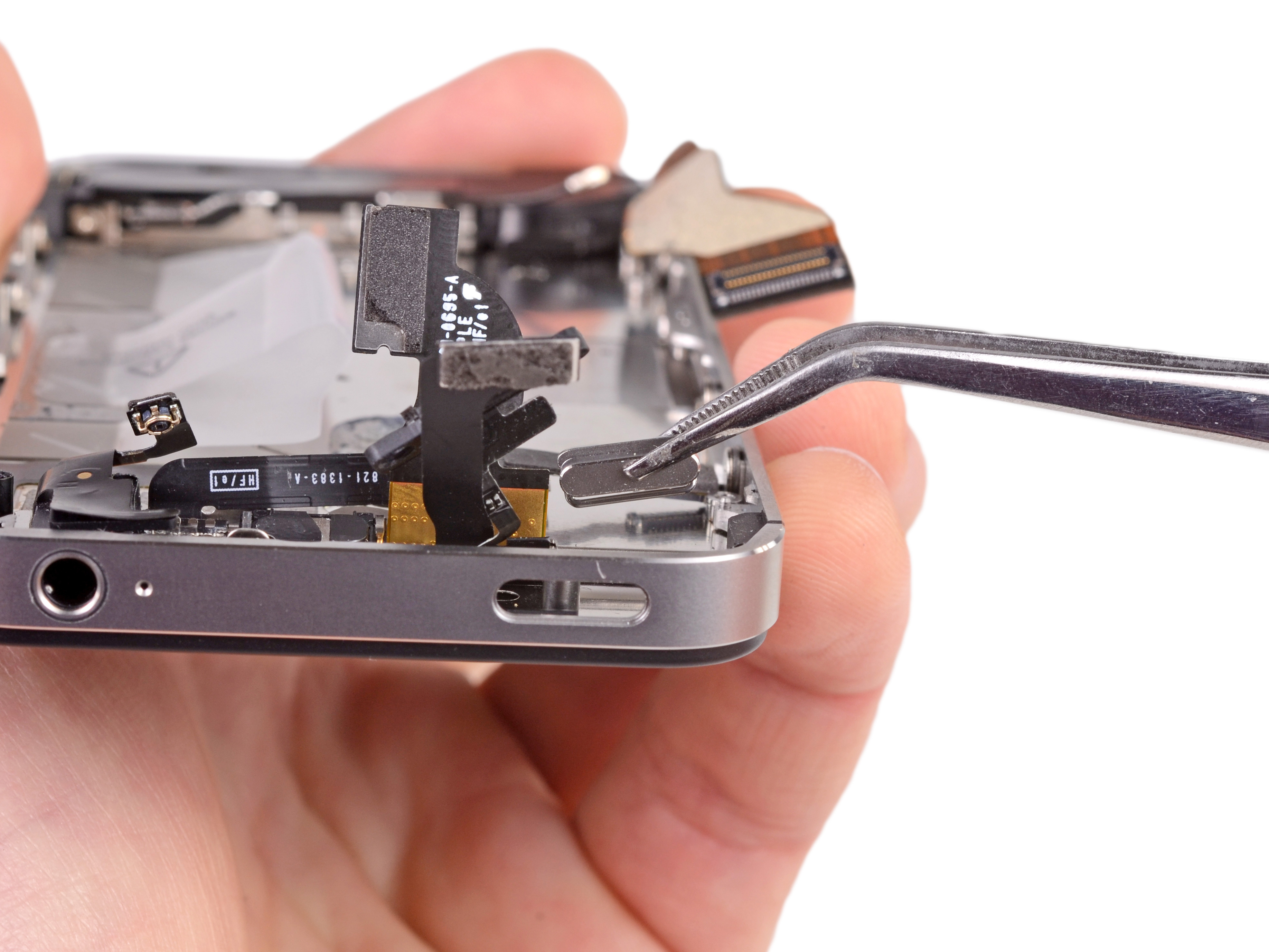

  28. iPhone 4S Power Button Replacement, Power Button: step 28, image 1 of 2 iPhone 4S Power Button Replacement, Power Button: step 28, image 2 of 2
    • Remove the two 1.6 mm Phillips screws securing the power button bracket to the outer case.
    • Take extra care with the display cables, which can prevent easy access to the right-hand screw. The cables are easily damaged.
    • Slightly pull the power button bracket away from the outer case.
  29. iPhone 4S Power Button Replacement: step 29, image 1 of 2 iPhone 4S Power Button Replacement: step 29, image 2 of 2
    Tool used on this step:
    Buy
    • Use a pair of tweezers to remove the power button from the iPhone.
    • During reassembly, take note of the correct orientation of the power button. The metal loop should be facing downwards and the outward edges should be on top.
