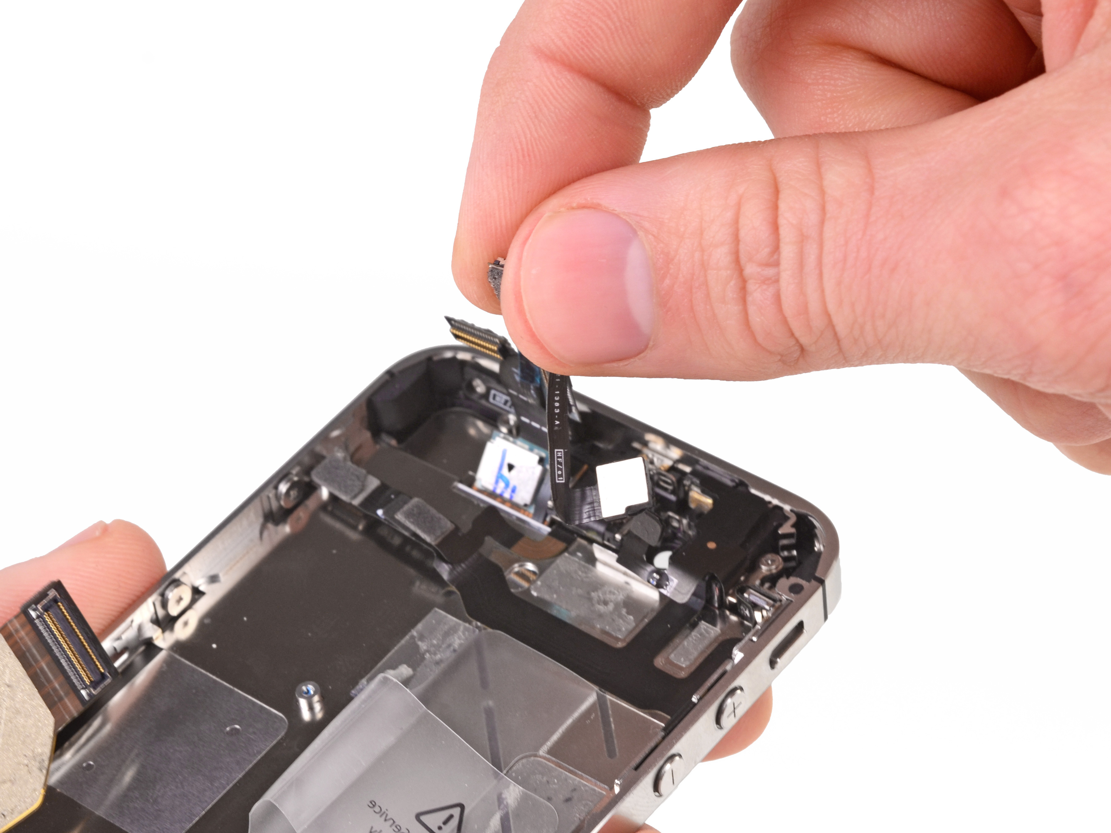

  28. iPhone 4S Front Facing Camera Replacement, Front Facing Camera: step 28, image 1 of 2 iPhone 4S Front Facing Camera Replacement, Front Facing Camera: step 28, image 2 of 2
    • Use the edge of a plastic opening tool to carefully pry the metal front facing camera retainer away from the case of your iPhone.
    • Remove the front facing camera retainer.
  29. iPhone 4S Front Facing Camera Replacement: step 29, image 1 of 1
    • Remove the front facing camera.
