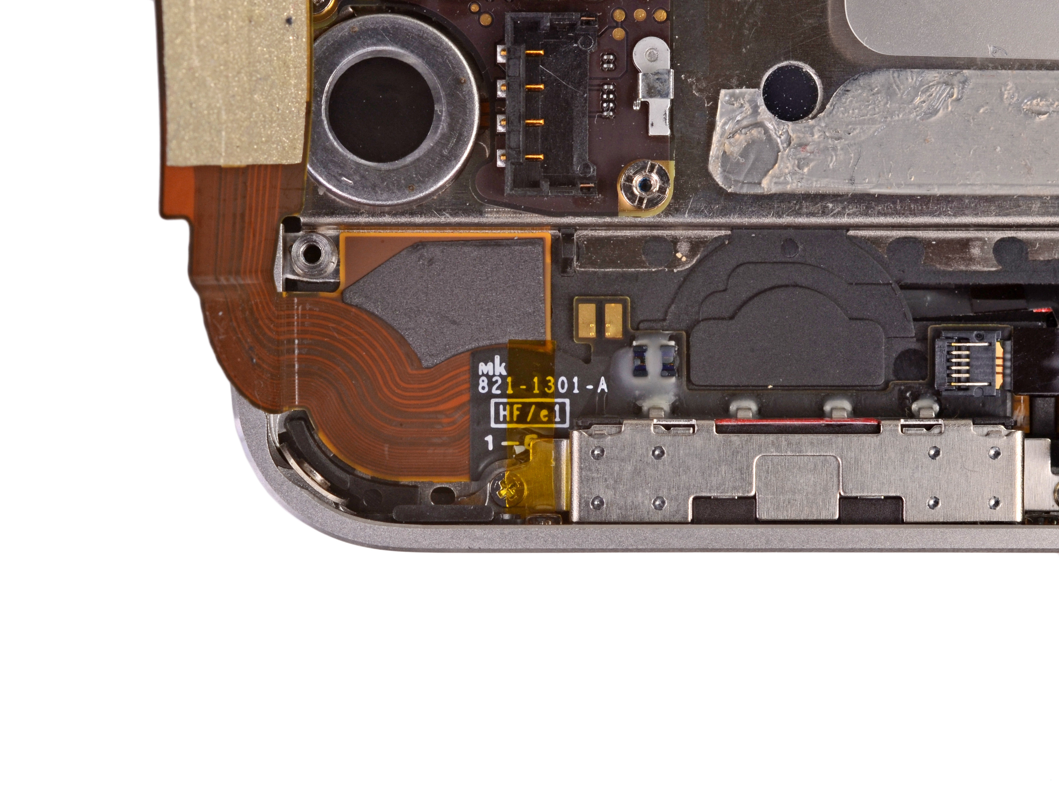

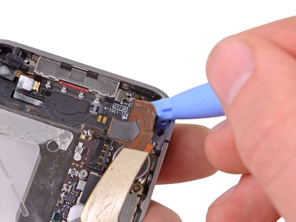

Add Note Edit Step 21  ¶
  • Use the edge of a plastic opening tool to peel the dock connector and its cable off the black plastic case of the iPhone.
  • If you are replacing the dock connector with a new part, make sure to transfer the rubber casing around the microphone. You can do this using a spudger.

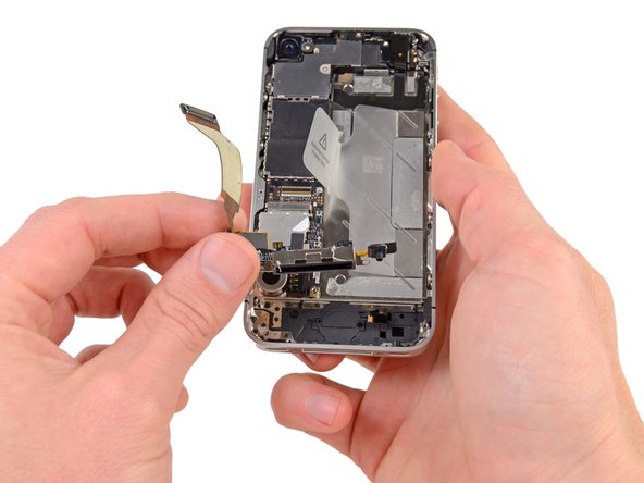

Image #1 Image #2
Add Note Edit Step 22  ¶
  • Pry the dock connector away from its opening at the bottom of the iPhone.
  • Remove the dock connector.
