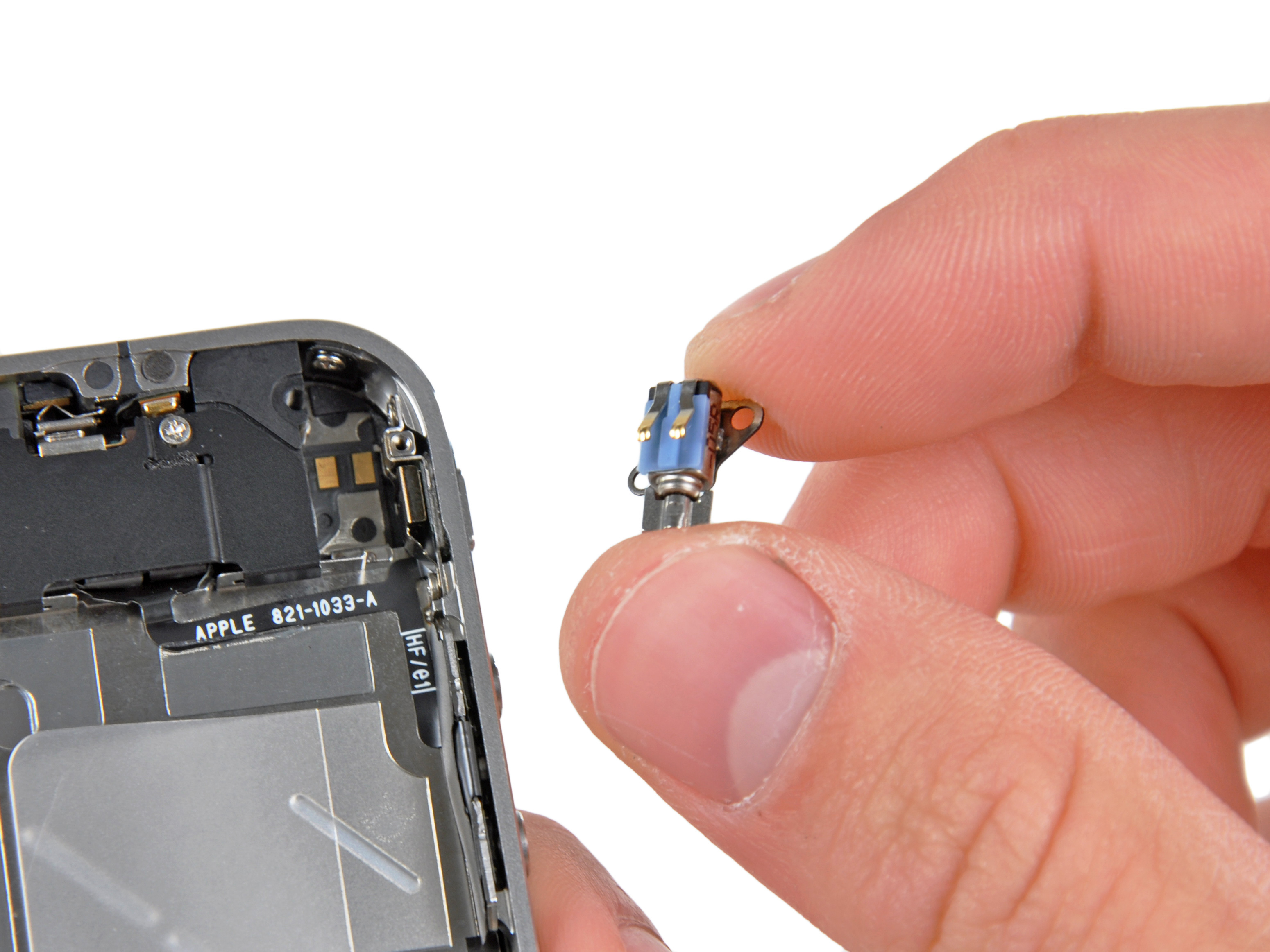

Add Note Edit Step 6 — Vibrator  ¶
  • Remove the following two screws securing the vibrator to the inner frame:
    • One 6 mm Phillips
    • One 1.4 mm Phillips
Image #1
Add Note Edit Step 7  ¶
  • Remove the vibrator from the inner case.
