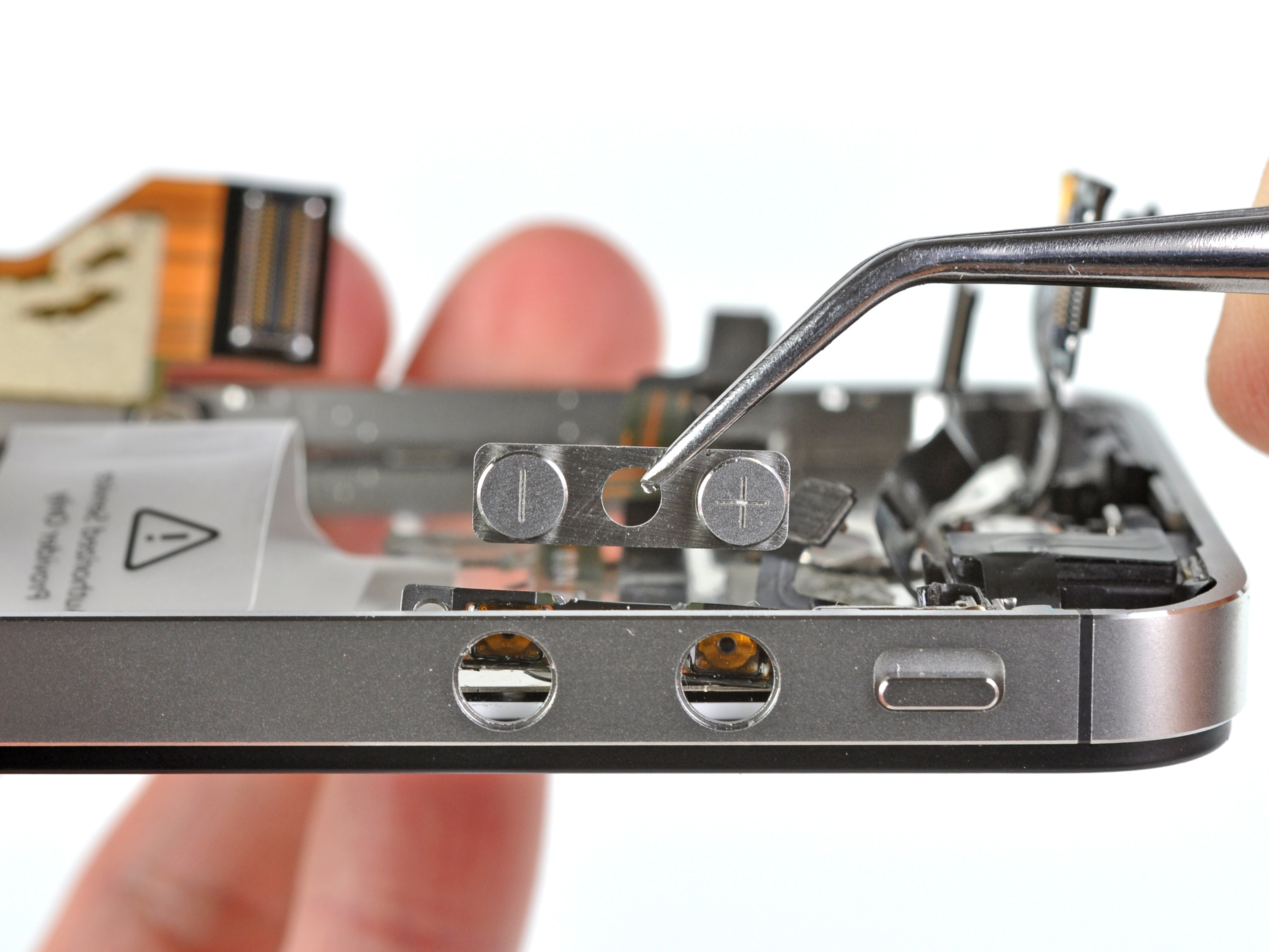

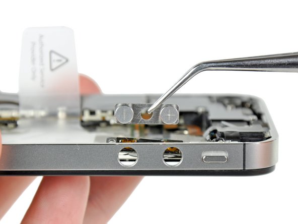

Add Note Edit Step 7 — Volume Buttons  ¶
  • Remove the three 1.6 mm Phillips screws securing the volume button bracket to the outer case.
Image #1
Add Note Edit Step 8  ¶
  • Pull the volume bracket slightly away from the outer case.
  • Use a pair of tweezers to remove the volume buttons from the iPhone.
