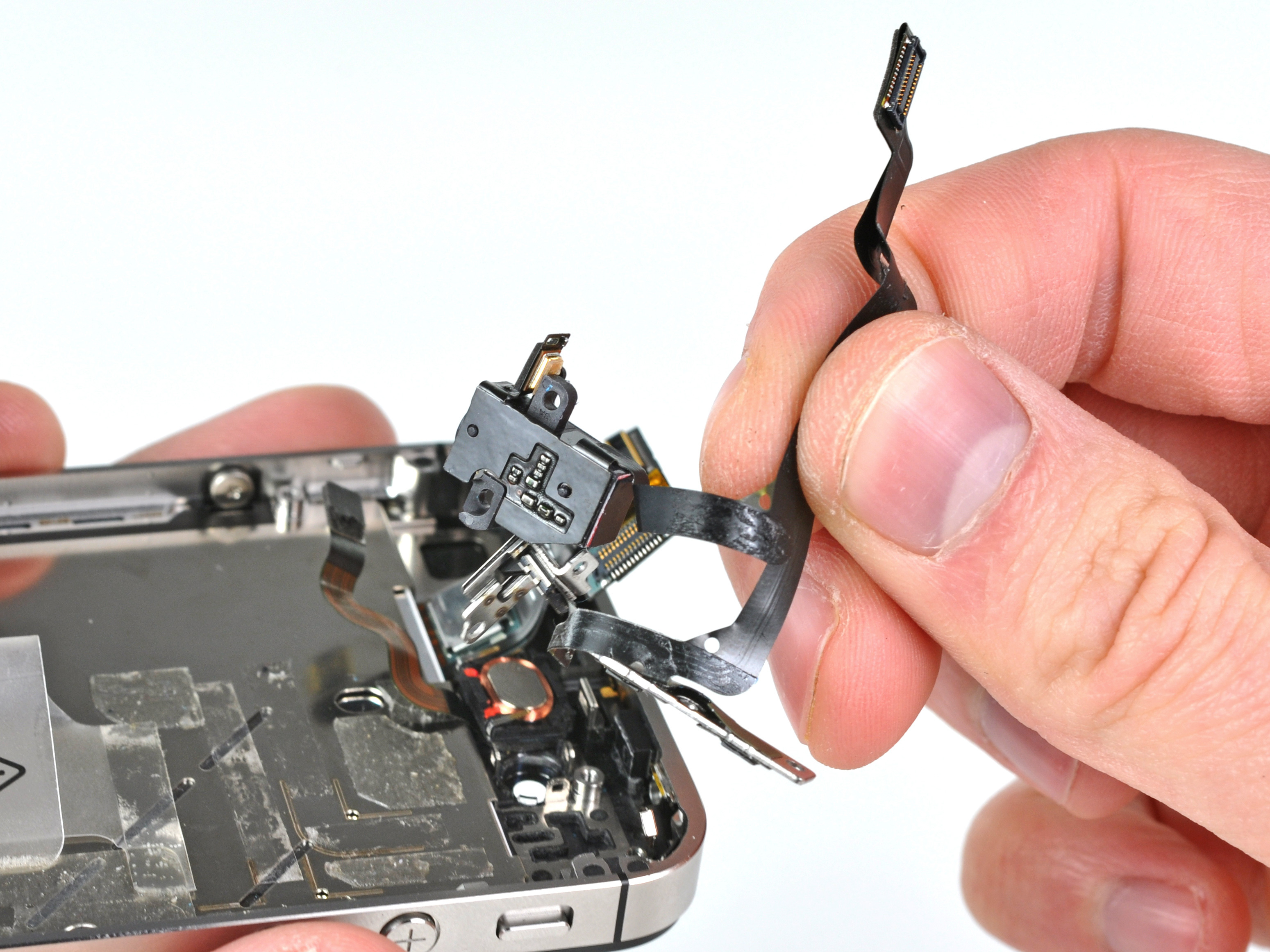

  32. iPhone 4 Verizon Headphone Jack Cable Replacement, Headphone Jack Cable: step 32, image 1 of 1
    • Remove the four 1.6 mm Phillips screws securing the volume button and silent switch brackets to the outer case.
  33. iPhone 4 Verizon Headphone Jack Cable Replacement: step 33, image 1 of 1
    • Carefully peel the headphone jack/volume button cables off the adhesive securing them to the rear case.
  34. iPhone 4 Verizon Headphone Jack Cable Replacement: step 34, image 1 of 1
    • Gently pull the silent switch bracket away from the outer case and peel its small ribbon cable off the inside of the iPhone.
  35. iPhone 4 Verizon Headphone Jack Cable Replacement: step 35, image 1 of 1
    • Remove the headphone jack cable from the iPhone.
  36. iPhone 4 Verizon Headphone Jack Cable Replacement: step 36, image 1 of 3 iPhone 4 Verizon Headphone Jack Cable Replacement: step 36, image 2 of 3 iPhone 4 Verizon Headphone Jack Cable Replacement: step 36, image 3 of 3
    • If you are replacing the headphone jack cable, use the edge of a plastic opening tool to remove the steel brackets for the volume buttons and the silent switch.
    • Transfer these steel brackets to the new headphone jack cable.
