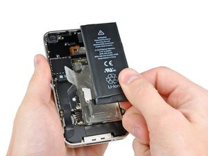

  6. iPhone 4 Verizon Battery Replacement: step 6, image 1 of 2 iPhone 4 Verizon Battery Replacement: step 6, image 2 of 2
    • Pull up on the exposed clear plastic tab to peel the battery off the adhesive securing it to the iPhone.
    • If the tab breaks before the battery is freed, apply a few drops of high concentration (over 90%) isopropyl alcohol under the edge of the battery. Wait about one minute for the alcohol solution to weaken the adhesive. Carefully slide a spudger under the battery tab to release the adhesive.
    • Prying in other places may cause damage. Don't try to forcefully lever the battery out. If needed, apply a few more drops of alcohol to further weaken the adhesive. Never deform or puncture the battery with your pry tool.
    • If there's any alcohol solution remaining in the phone, carefully wipe it off or allow it to air dry before installing your new battery.
    • Remove the battery.

I actually had the plastic tab break off when I was trying to remove the battery. Any advice?
SOCRATES8181 - Reply
Na Aula,diz pra vc coloca álcool isopropílico 90% pra enfraquecer a cola do.
Gilmar Dutra -
The plastic opening tools were amazing flimsy- the tips broke off both of them while trying to get the battery out.
The adhesive attaching the battery was very strong and the pull tab actually ripped, though it did not come off.
sunilkamath - Reply
When I replace my battery for a new one it says accesory not permited or something like that, and I tried with every single battery I found (iphone 4 GSM, Iphone 4s..) is there something I could do? is the battery of iphone 4 CDMA Verizon different from others?
Daniele Gugliotta - Reply
I have a Verizon iPhone 4. Got it the first day Verizon started selling them over 2 years ago. Followed the guide. Completed the task in 10 mins. The battery adhesive must have weakened some. Did not need to use pull tab at all. Just the pry tool along the outer side of battery as mentioned by other users. Thanks ifixit!! Saved me a contract slot. With a family of 4, that is a big savings.
mmagalski - Reply
