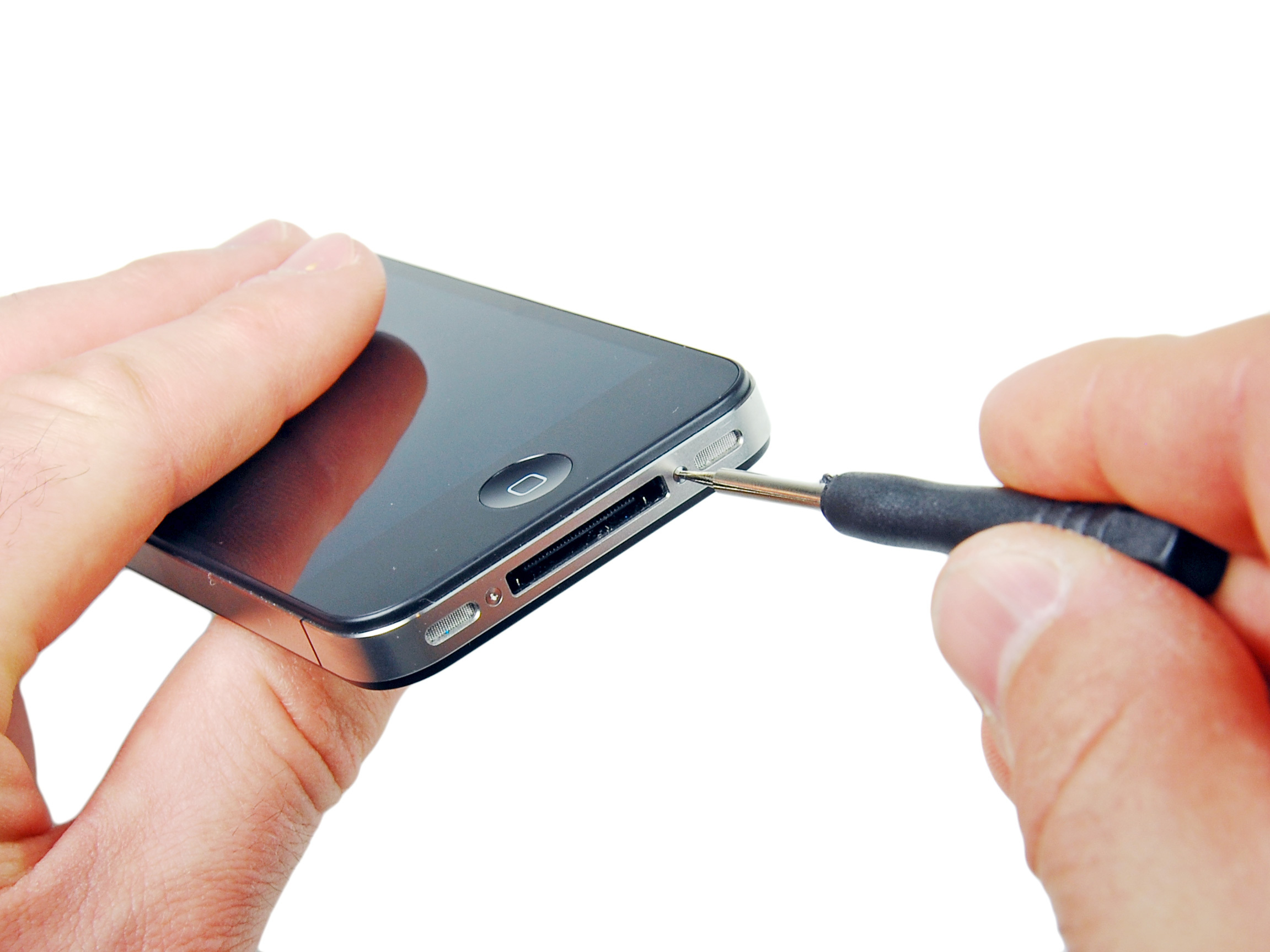

Apple has substituted the two bottom Phillips screws near the dock connector with 5-point "Pentalobular" screws.
This guide will illustrate how to replace the Pentalobe screws with good ol' regular Phillips screws.

  • Before we proceed, let's make sure you have the correct tools for the job.
  • iFixit's iPhone 4/4S Liberation Kit includes:
    • One 5-Point "Pentalobe" screwdriver
    • One #00 Phillips screwdriver
    • Two 3.6 mm "Liberation" Phillips screws
  • Are you ready to break the shackles of hardware oppression and liberate your iPhone? Let's rock!

  • Use the Pentalobe screwdriver to remove the two 3.6 mm Pentalobe screws near the dock connector.
  • The 5-Point Pentalobe screwdriver should only be used a limited number of times because it has the potential to strip the screws.

  • Insert the two 3.6 mm Phillips screws into the screw holes using the provided #00 Phillips screwdriver.
  • Huzzah! Your iPhone should now be liberated from those pesky "Pentalobular" screws.
