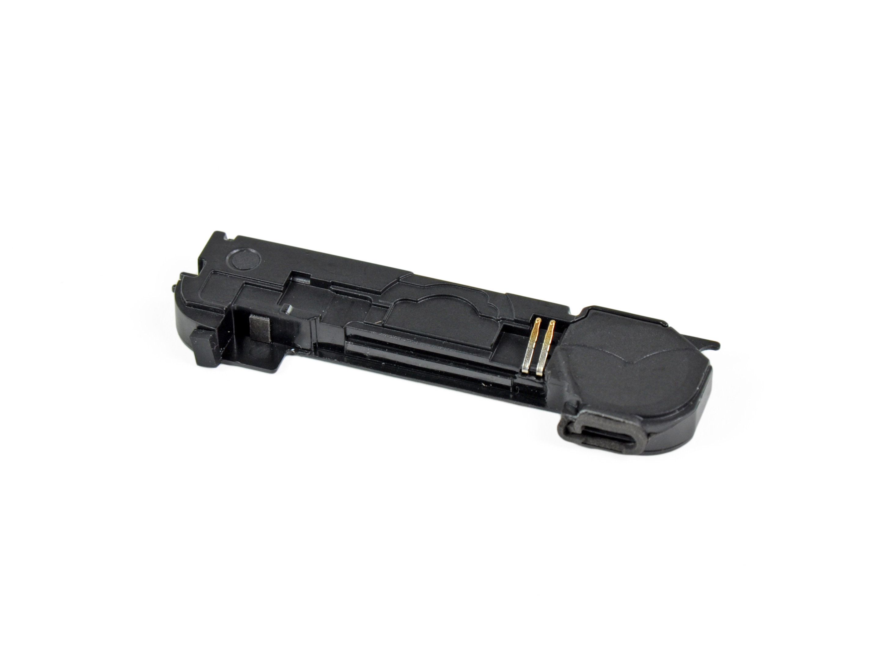

Image #1
Add Note Edit Step 23 — Speaker Enclosure  ¶
  • Speaker enclosure remains.
