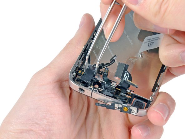

  • Use a pair of tweezers to pull the body of the headphone jack out of the outer case.
  • Take extra caution to avoid ripping the thin cable.
Image #1
Add Note Edit Step 26  ¶

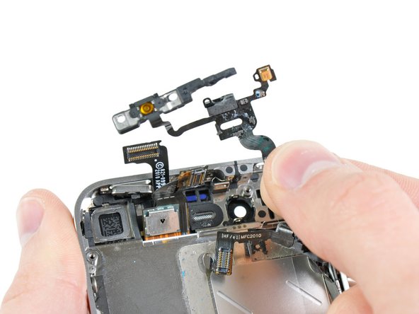

  • Grab the power & sensor cable near the microphone and peel it off the front panel, being careful not to rip it in the process.
Image #1
Add Note Edit Step 27  ¶
  • Remove the power & sensor cable from the iPhone 4.
Image #1
Add Note Edit Step 28  ¶
  • If you are replacing the power & sensor cable with a new unit, use the edge of a plastic opening tool to peel the electronic power switch off its metal bracket.
  • Also be sure to transfer the proximity sensor shroud/filter adhered to the old power & sensor cable if your new one does not already come with one.
  • Transfer the bracket to your new power & sensor cable.
