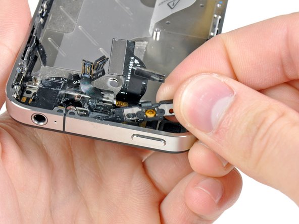

Add Note Edit Step 21 — Power & Lock Button  ¶
  • Remove the two 1.5 mm Phillips screws securing the power button bracket to the outer case.
Image #1
Add Note Edit Step 22  ¶
  • Carefully lift the power button bracket out of the outer case, minding its thin and delicate ribbon cable.
  • The power button bracket is made of very weak cast aluminum and is easily cracked. Handle with caution.
Image #1
Add Note Edit Step 23  ¶
  • Use a pair of tweezers to remove the power & lock button from the iPhone.
