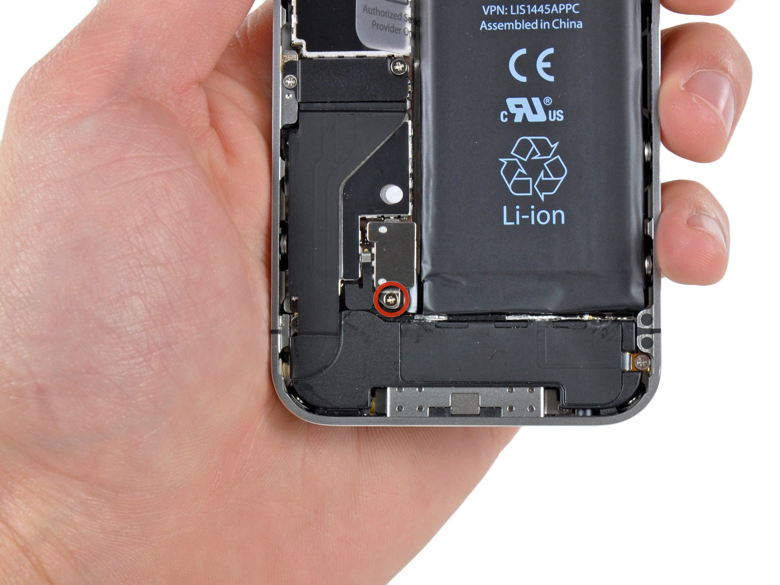

  4. iPhone 4 Contact Clip Replacement, Contact Clip: step 4, image 1 of 1
    • Remove the single 2.5 mm Phillips screw securing the battery connector to the logic board.
  5. iPhone 4 Contact Clip Replacement: step 5, image 1 of 3 iPhone 4 Contact Clip Replacement: step 5, image 2 of 3 iPhone 4 Contact Clip Replacement: step 5, image 3 of 3
    • Use an iPod opening tool to carefully pry the battery connector up from the ends closest to the top and bottom edges of the iPhone.
    • Do not pry against the contact clip.
    • Remove the contact clip from the iPhone.
    • Before reconnecting the battery connector, be sure the pressure contact (shown in red) is properly positioned next to the battery connector.
    • Before reassembly, be sure to clean all metal-to-metal contact points on the pressure contact as well as its contact point on the rear panel with a de-greaser such as windex. The oils on your fingers have the potential to cause wireless interference issues.
