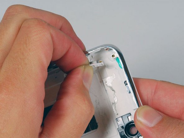

Add Note Edit Step 25 — Rear Case  ¶
  • Remove the on/off switch button from the iPhone.
  • The lock button is attached to a metal handle. It can rotate 180º in one side and 135º in the other. When putting it back remember to rotate 180º so that the metal handle faces down (towards the back panel).

Add Note Edit Step 26  ¶
  • Remove the mute button from the iPhone.

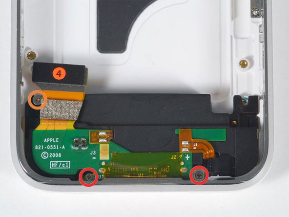

Add Note Edit Step 28  ¶
  • Remove the following 3 screws:
    • Two 1.5 mm Phillips #00 screws, one on either side of the dock connector.
    • One 2.4 mm Phillips #00 screw near the ribbon cable labeled "4."
Image #1
Add Note Edit Step 29  ¶
  • Lift the dock connector assembly up and out of the iPhone.
  • Pay close attention as to the position of the dock connector assembly. When you re-assemble the phone, make sure everything lines up. The assembly actually goes OVER the bezel screw holder. If you place it UNDER the bezel screw holder the Home Button will not work.

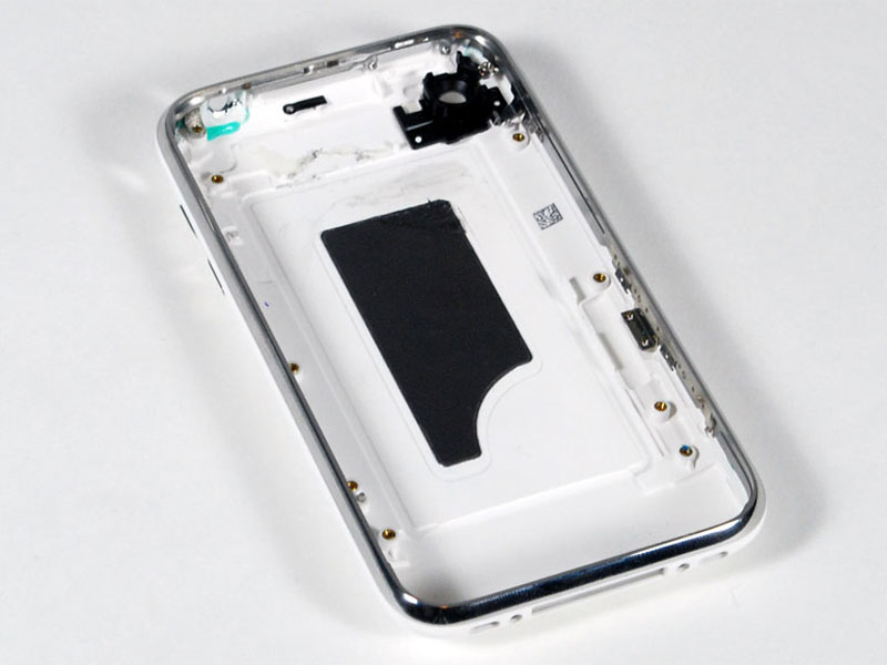

Add Note Edit Step 30  ¶
  • The rear case and attached front bezel remain.
