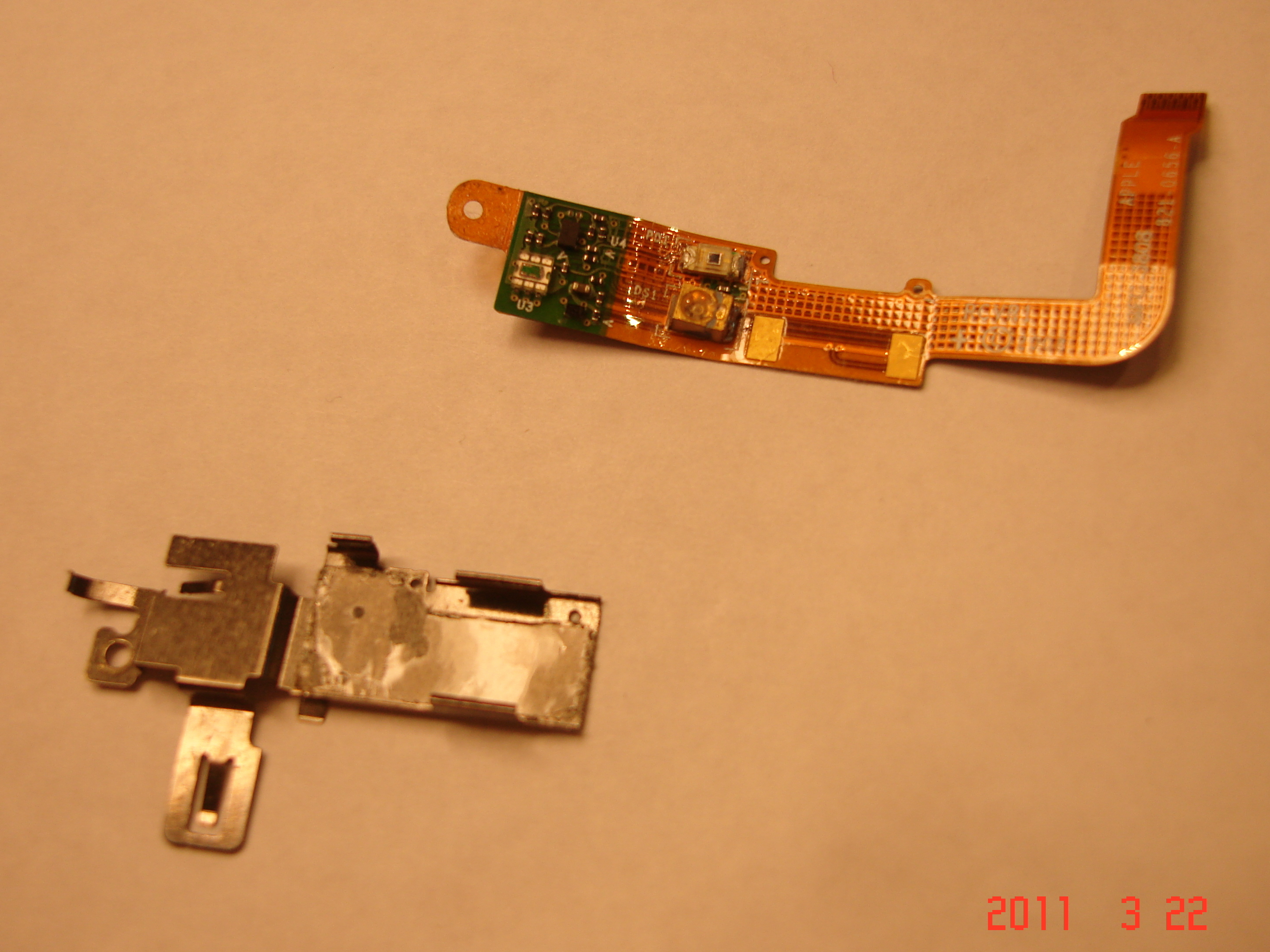

Removal of the original ribbon is a bit tricky. I use an automotive type of pick tool to remove the existing ribbon bracket. Read on for details on this repair.
NOTE: Many vendors online sell defective units, and these ribbons damage easily. When buying, buy a few because you may go through 3-4 before you get a good one.

Add Note Edit Step 1 — Proximity Sensor Ribbon  ¶
  • Remove the screw that holds this bracket in and put it in a safe place.
Image #1
Add Note Edit Step 2  ¶
  • Use an automotive pick tool to lift the bracket up on the side of where the speaker lies. Slight upward pressure, do not force or pry.
Image #1
Add Note Edit Step 3  ¶
  • Do the same with the other side and on the bottom of the bracket. This is held in with tension on fingers that clip into the screen midframe.
Image #1
Add Note Edit Step 4  ¶
  • Once the bracket is loose, you can pull it up carefully maneuvering it up and around the LCD and digitizer connectors.
Image #1
Add Note Edit Step 5  ¶
  • Peel the old ribbon from the bracket, note the orientation.
Image #1
Add Note Edit Step 6  ¶
  • Peel off the adhesive backing protectors from the new ribbon, and line up the holes in the ribbon with the ones on the bracket as so.
Image #1
Add Note Edit Step 7  ¶
  • Use a small screwdriver's shaft to conform the new ribbon to the bracket's contour. Light pressure is only needed.
  • At the top of the ribbon, note that there are two small holes. Align them with the two holes in the metal piece for a perfect fit.
Image #1
Add Note Edit Step 8  ¶
  • Lift the digitizer and LCD connectors and snap in the bracket/ribbon combo to finish it off.
