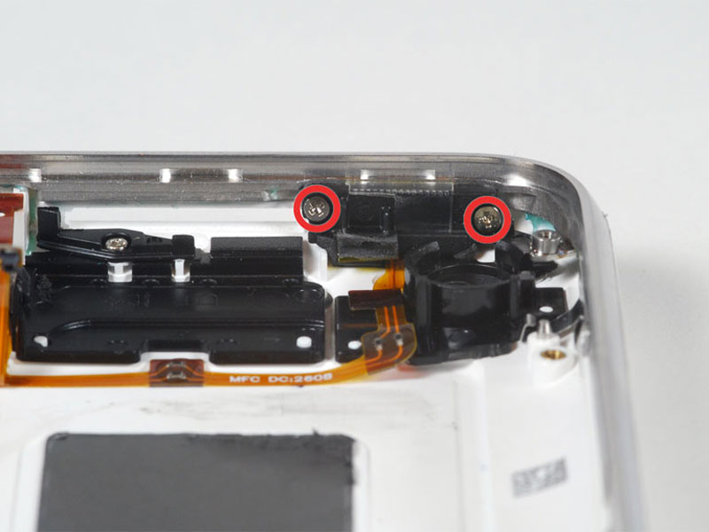

  17. iPhone 3G Headphone Jack Replacement, Headphone Jack: step 17, image 1 of 1
    • Remove the two Phillips #00 screws securing the on/off switch to the front bezel.
    • When replacing, check the protrusion of the switch. There is a small plastic spacer adhered to the inside of button which may come off with cleaning. Without a spacer, the button may not protrude enough to be depressed. If lost, it can be replaced with a suitable thickness of stiff plastic (eg shirt box lid).
