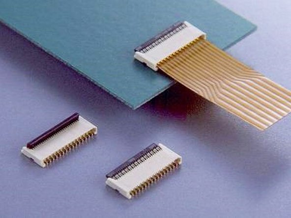

    • Ribbon cable "3" is held in place by a FPC style connector. You must unlock this connector before sliding the ribbon cable out. The locking mechanism is on the opposite side of where the cable is inserted - it swivels upwards 90 degrees. Use a plastic spudger to lift the locking mechanism.
    • The FPC locking latch is very delicate and is typically a different color than the body of the connector. (see the detail image of FPC connector open and closed)
    • Slide the ribbon cable out of the connector, and remove the display assembly from the iPhone.
    • It's impossible to properly reinsert a ribbon into an FPC connector unless the lock is disengaged. Make sure the locking latch is open when attaching/detaching the cable.

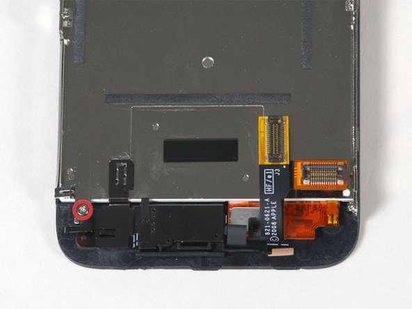

  8. iPhone 3G Display Replacement: step 8, image 1 of 1
    • Remove the single Phillips #00 screw from the corner of the display assembly.

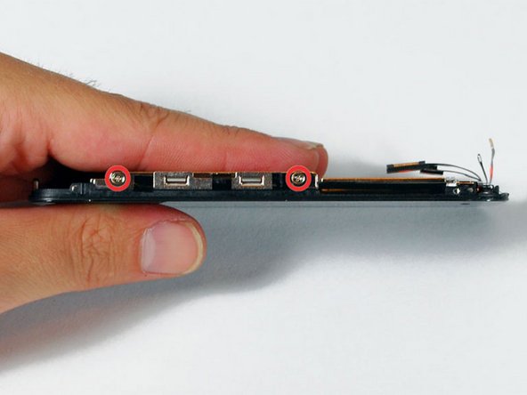

  9. iPhone 3G Display Replacement: step 9, image 1 of 1
    • Remove the two Phillips #00 screws from the right side of the display assembly.

Hi there, Just been reading these a lot and I think that people should not use a metal spudger inside the phone as this will potentially short out the phone inside as it is still connected to the battery pack. I also recommend that people observe some basic ESD precautions. Like earthing yourselves etc.
Dave G - Reply
I wrote up my notes, including the critical (missing) PFC lock directions in a separate blog post:
http://tech.kateva.org/2011/01/repair-of...
jfaughnan - Reply
