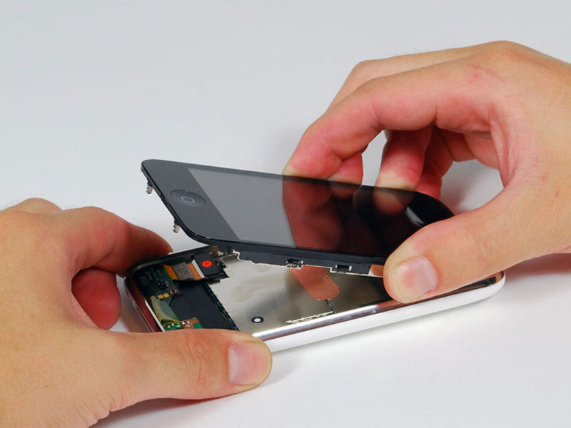

Add Note Edit Step 1 — Display Assembly  ¶
  • Remove the two Phillips #00 screws from the dock-connector end of the iPhone.
Image #1
Add Note Edit Step 2  ¶
  • Remove the metal handle from the suction cup. It's easier and safer to grip the suction cup's base instead of the metal handle.
  • Be very careful when opening the iPhone so that the cables under the display are not severed.
  • There is a rubber gasket between the silver front bezel and black display assembly. A bit of force is required in this step to separate the iPhone's display assembly.
  • Use a small suction cup near the Home button to gently pull up the bottom portion of the iPhone's display assembly.
  • If the display assembly is too damaged to allow the suction cup to adhere, tape with a strong adhesive such as duct tape may be used.
Image #1
Add Note Edit Step 3  ¶
  • The display assembly is still connected to the iPhone by several cables, so don't try to remove it entirely just yet.
  • Rotate the display assembly up until it is at an angle of approximately 45 degrees.
Image #1
Add Note Edit Step 4  ¶
  • Continue to hold the display assembly with one hand, and use your other hand and a spudger to disconnect the black ribbon cable labeled "1."
Image #1
Add Note Edit Step 5  ¶
  • Rotate the display assembly up until it is roughly vertical. This will allow easier access for disconnecting the remaining cables.
  • Use a spudger to disconnect the black ribbon cable labeled "2."
Image #1
Add Note Edit Step 6  ¶
  • Use a spudger to flip up the black plastic tab holding the remaining ribbon cable in place. The black will rotate up 90 degrees, releasing the ribbon cable.
  • The tab is very fragile, so be careful when flipping it up to unlock the cable and down to lock the cable.
  • The plastic tab may be white (instead of black) on some iPhone models.
  • Slide the ribbon cable out of its connector, and remove the display assembly from the iPhone.
