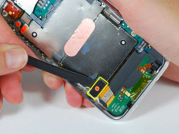

  9. iPhone 3G Camera Replacement: step 9, image 1 of 1
    • Use a spudger to disconnect the ribbon cable labeled "4."

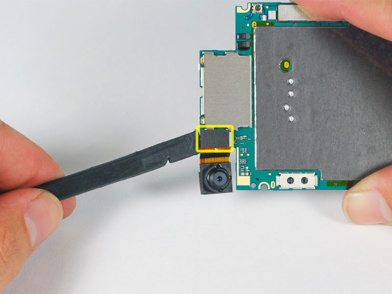

  17. iPhone 3G Camera Replacement: step 17, image 1 of 1
    • Use a spudger to disconnect the camera from the logic board.
