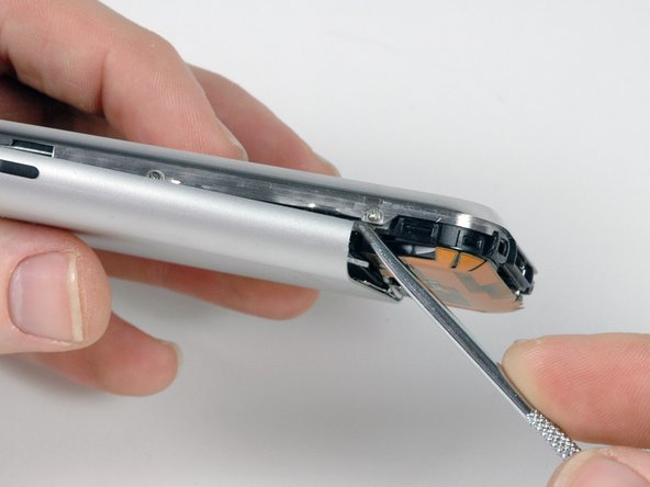

  • Be sure to slide the metal spudger between the dock connector and the antenna cover, and not into the dock connector itself.
  • Insert a metal spudger into the slot between the dock connector and the antenna cover. Gently pry up near the two tabs to create a small gap between the antenna cover and the silver front bezel.

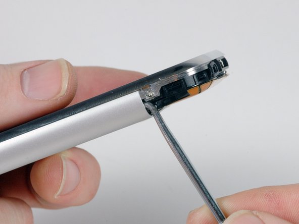

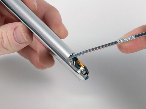

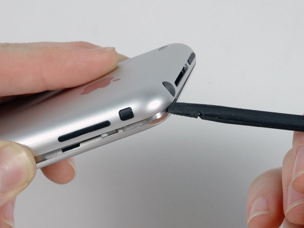

  • Use a spudger to free the rear panel from the iPhone along the corner and top.
Image #1

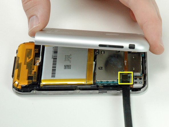

  • Pry up the rear panel by pulling the dental pick counterclockwise in a quick motion. Apply force perpendicular to the plane of the display assembly. You may be afraid to go fast, but going slowly is more likely to bend the case.
  • The rear panel is still attached to the iPhone by the headphone jack cable, so don't entirely remove the rear panel from the iPhone just yet.
Image #1

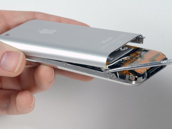

Add Note Edit Step 14  ¶
  • Make sure the phone is off before disconnecting the headphone jack cable.
  • Use a spudger to disconnect the headphone jack cable from the logic board.
Image #1

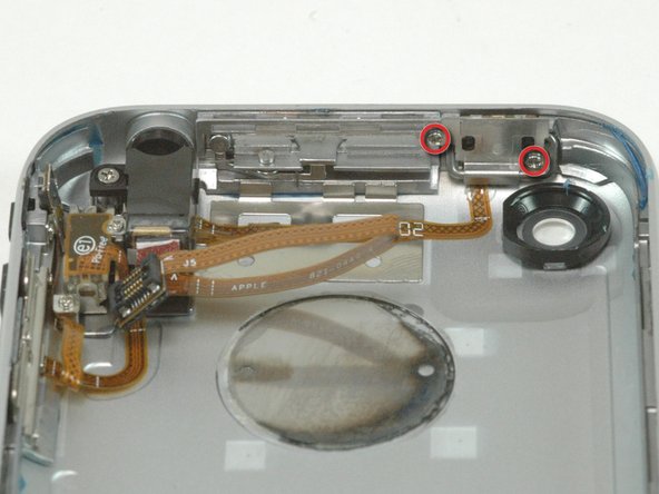

Add Note Edit Step 15  ¶
  • Remove the two Phillips #00 screws securing the on/off switch to the rear panel.
Image #1

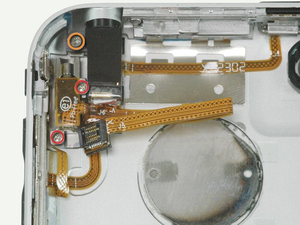

  • Remove the following 3 screws:
    • Two Phillips #00 screws securing the vibrator to the rear panel.
    • One larger head and longer Phillips #00 screw securing the headphone jack to the rear panel.
Image #1

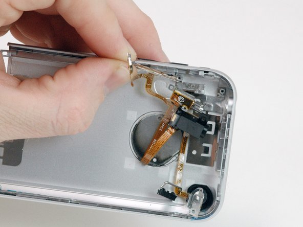

  • Grasp the metal screw plate attached to the on/off switch and lift slightly up and away from the rear panel. The button should come with the cable.
  • Gently peel up the on/off switch ribbon cable. Be sure to pull near where the ribbon cable is glued to the rear panel.
Image #1
Add Note Edit Step 18  ¶

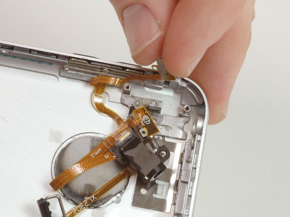

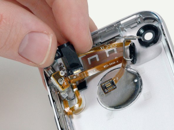

  • The headphone jack is slightly recessed into the rear panel. First slide the headphone jack away from its housing and then lift it up slightly (only 1/4 inch or 1/2 centimeter) so that it is no longer in the rear panel.
Image #1

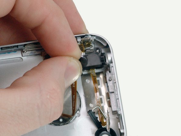

Add Note Edit Step 19  ¶
  • Grasp the headphone jack at the tip and gently lift up, pulling the vibrator out of the rear panel.
Image #1

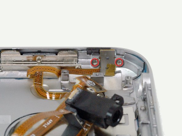

  • Remove the two Phillips #00 screws securing the silent/ring switch to the rear panel.
  • Pry off the metal backing with the screw holes and save for securing the replacement switch.

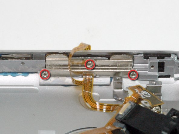

Add Note Edit Step 22  ¶
  • Remove the three Phillips #00 screws securing the volume switch to the rear panel.
Image #1
