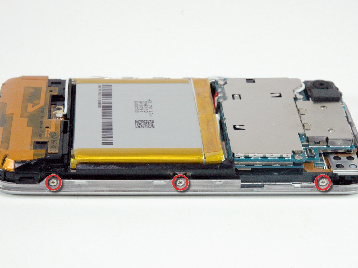

Add Note Edit Step 7 — Case  ¶
  • Remove the three Phillips #00 screws securing the rear panel to the iPhone.
Image #1
Add Note Edit Step 8  ¶
  • Getting the iPhone open is a challenging feat, so don't get discouraged. Take a deep breath and make sure you have plenty of time to get the job done.
  • The small square hole is the location to insert the dental pick in the next step.
