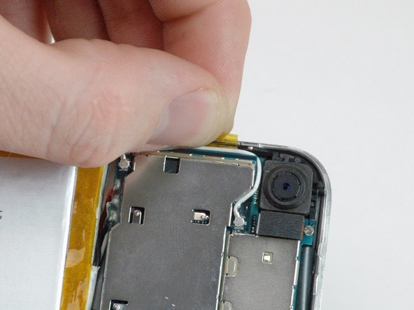

  • Peel up the orange tape securing the white antenna cable to the side of the iPhone.
Image #1

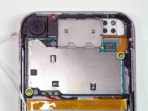

Add Note Edit Step 17  ¶

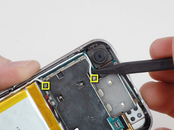

  • Remove the following 3 screws:
    • One Phillips #00 screw securing the logic board to the iPhone near the camera.
    • Two Phillips #00 screws, one on either corner of the logic board.
Image #1

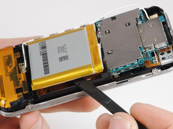

  • Working from the edge opposite the battery connectors, insert a spudger between the battery and the plastic frame and pry up on the battery. It is attached to the casing with an adhesive, but should slowly come free.
  • Leave the battery resting slightly out of its housing, but be sure not to put too much pressure on the battery wires as the solder joints break easily.
Image #1

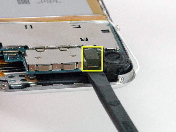

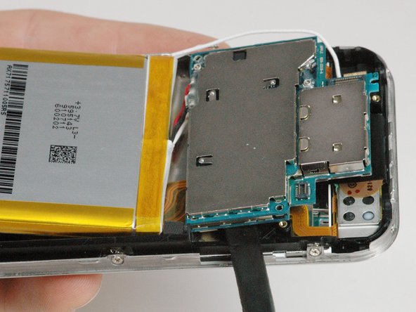

Add Note Edit Step 20  ¶
  • Slide a spudger beneath the logic board on the side opposite the battery connector and pry up slightly. Don't lift up too far, because there are still four attached connectors on the bottom of the logic board.
Image #1
Add Note Edit Step 21  ¶
  • In a similar manner, slide a spudger beneath the logic board where the camera was. Again, don't lift up too far yet as there are still four attached connectors on the bottom of the logic board.
Image #1

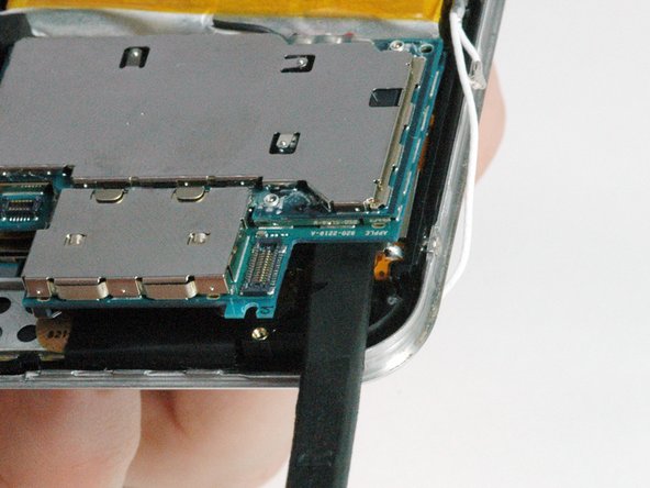

Add Note Edit Step 22  ¶

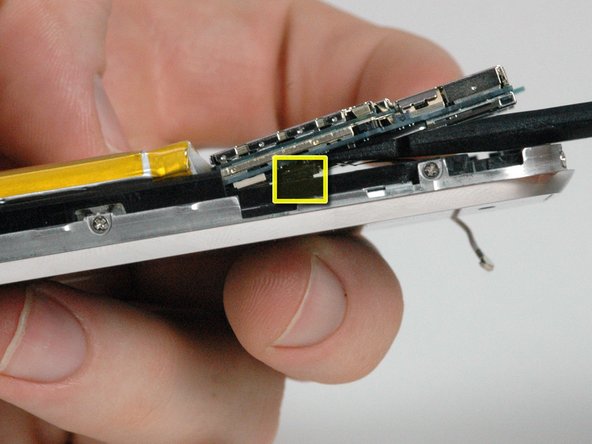

  • Lift up the logic board slightly and slide a spudger beneath the logic board to disconnect the display ribbon cable.
  • After freeing the first connector, slide the spudger further towards the battery and the center of the iPhone to disconnect the speaker connector.
Image #1

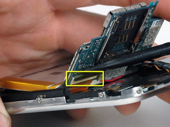

Add Note Edit Step 23  ¶

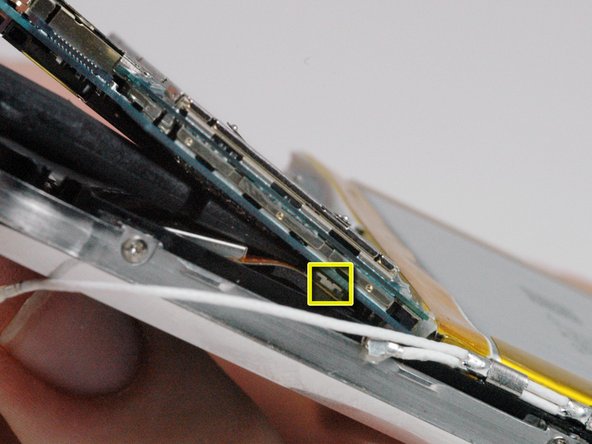

  • Go to the other side of the logic board and use a spudger to disconnect the touch sensor cable on the under side of the logic board.
Image #1

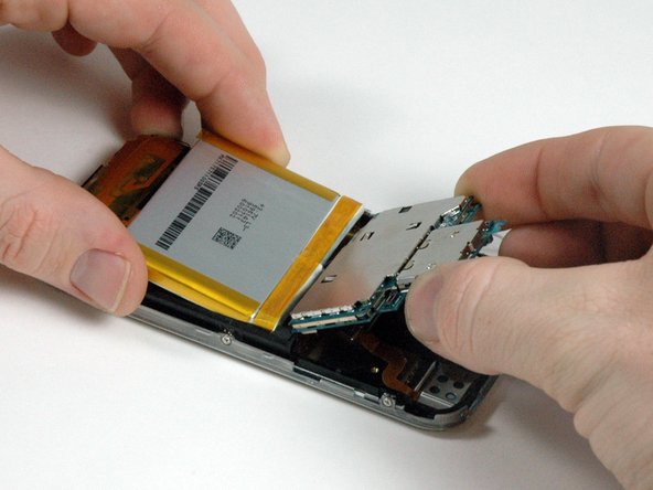

Add Note Edit Step 25  ¶
  • Hold both the battery and the logic board assembly and slide both parts away from the orange antenna and out of the iPhone.
Image #1

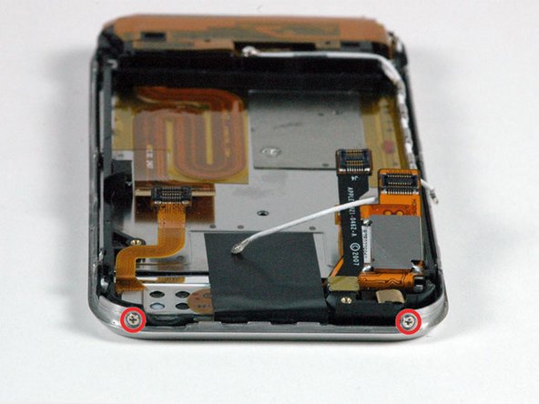

Add Note Edit Step 27  ¶
  • Rotate the iPhone 90 degrees and remove the two Phillips #00 screws from the bottom of the iPhone.
Image #1

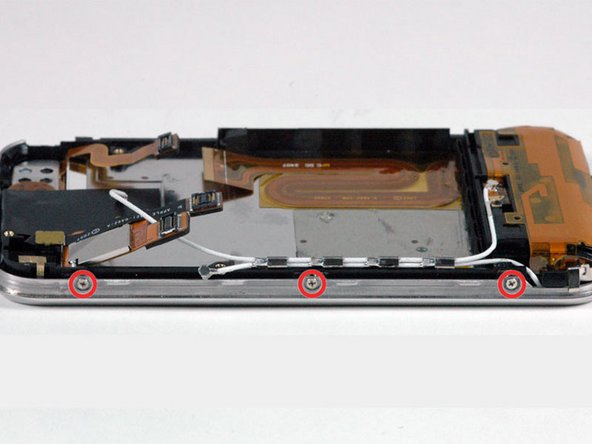

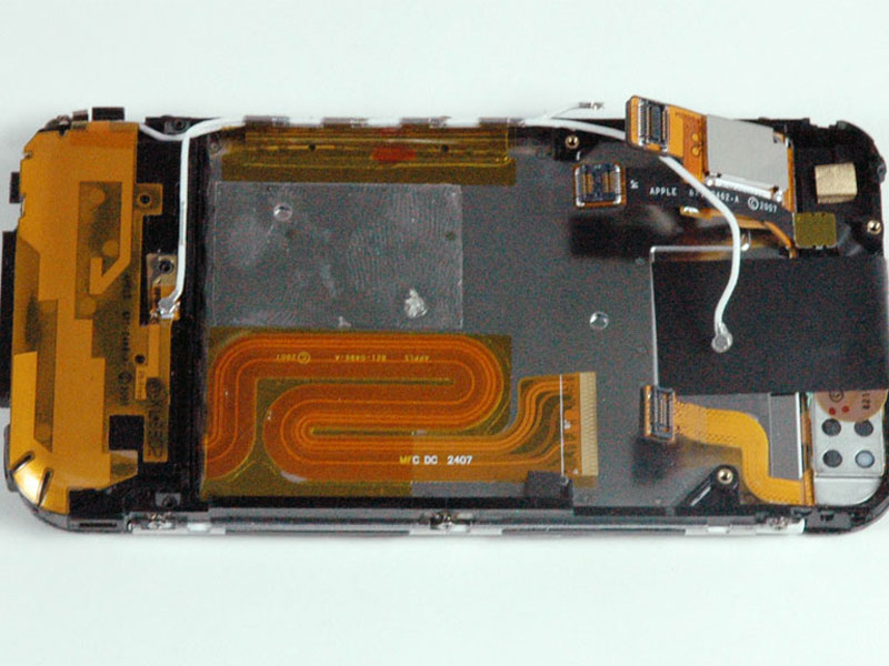

Add Note Edit Step 28  ¶

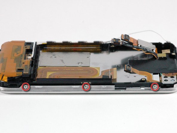

  • Rotate the iPhone 90 degrees and remove the three Phillips #00 screws from the side of the iPhone.
Image #1

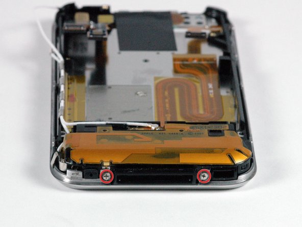

Add Note Edit Step 29  ¶
  • Rotate the iPhone 90 degrees and remove the two Phillips #00 screws from the top of the iPhone.
Image #1
Add Note Edit Step 30  ¶

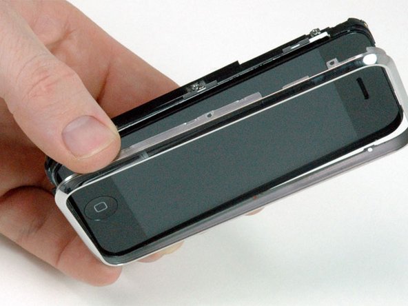

  • Lift the front bezel away from the iPhone.
Image #1
Add Note Edit Step 31  ¶
  • Display assembly remains.
