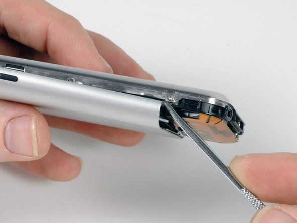

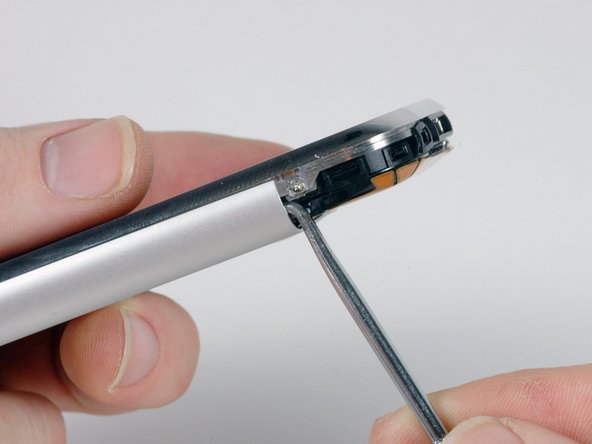

  • Start removing the rear panel on the side with the buttons.
  • Slide the dental pick completely into the square hole. You may need to wiggle the tool and apply a good amount of force to get it to go all the way.
Image #1
Add Note Edit Step 10  ¶
  • Pry up the rear panel by pulling the dental pick counterclockwise in a quick motion. Apply force perpendicular to the plane of the display assembly. You may be afraid to go fast, but going slowly is more likely to bend the case.
Image #1

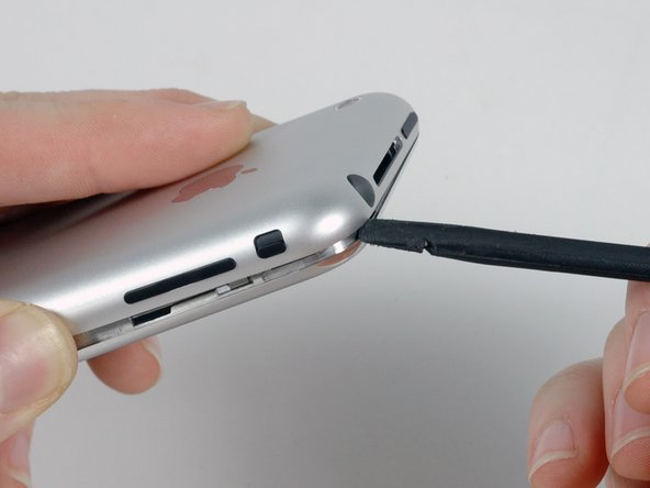

Add Note Edit Step 11  ¶
  • Use a spudger to free the rear panel from the iPhone along the corner and top.
Image #1

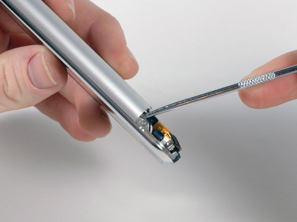

Add Note Edit Step 12  ¶
  • Repeat the same procedure on the other side of the iPhone. Slide the dental pick completely into the square hole. You may need to wiggle the tool and apply a good amount of force to get it to go all the way.
Image #1
Add Note Edit Step 13  ¶
  • Pry up the rear panel by pulling the dental pick clockwise in a quick motion. Apply force perpendicular to the plane of the display assembly. You may be afraid to go fast, but going slowly is more likely to bend the case.
  • The rear panel is still attached to the iPhone by the headphone jack cable, so don't entirely remove the rear panel from the iPhone just yet.
Image #1

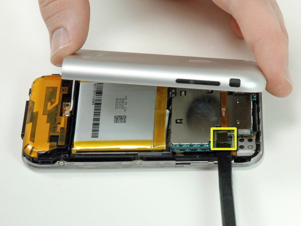

Add Note Edit Step 14  ¶
  • Make sure the phone is off before disconnecting the headphone jack cable.
  • Use a spudger to disconnect the headphone jack cable from the logic board.
Image #1

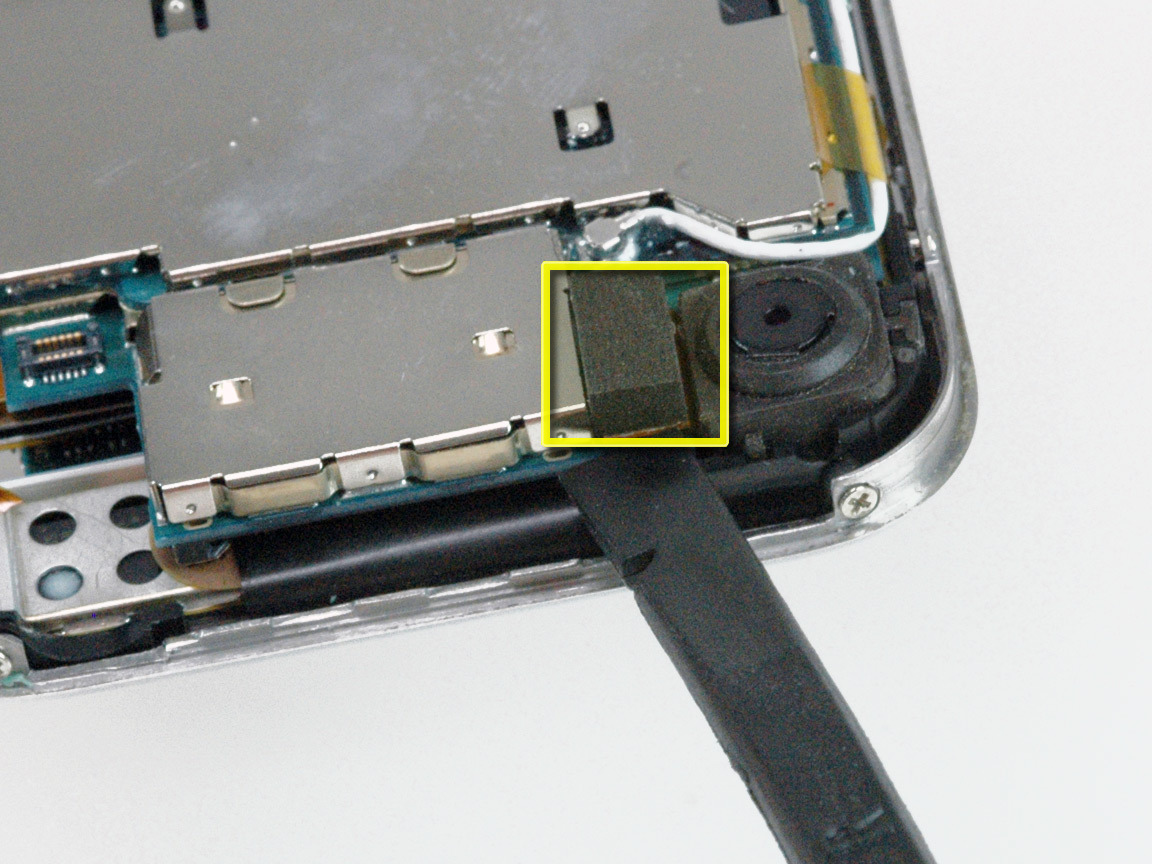

Add Note Edit Step 15 — Camera  ¶
  • Use a spudger to disconnect the camera connector.
Image #1

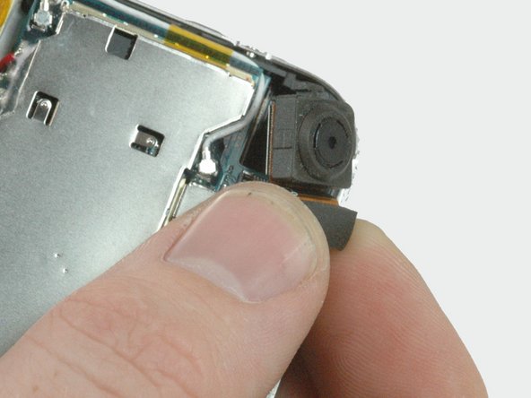

Add Note Edit Step 16  ¶
  • Lift the camera out of the iPhone.
