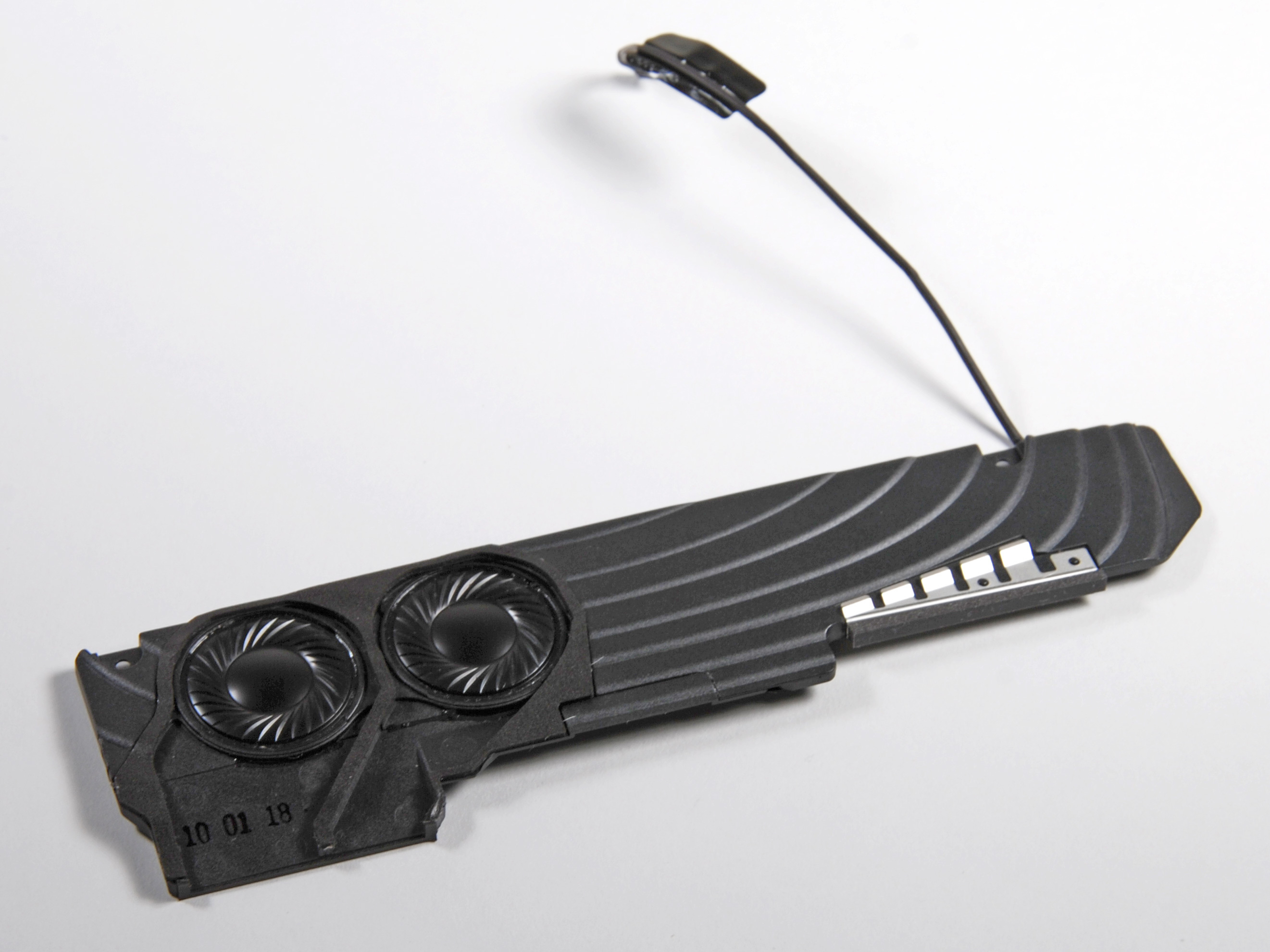

Installing iPad Wi-Fi Speakers
Replace your iPad Wi-Fi's speaker assembly.
Replace the speaker assembly and restore sound to your iPad.
